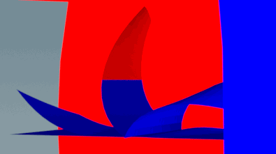

At least from a USD schema perspective, doubleSided means only visible when viewing the normal direction and invisible/culled when viewing the backside.
30 posts
Joined: June 2018

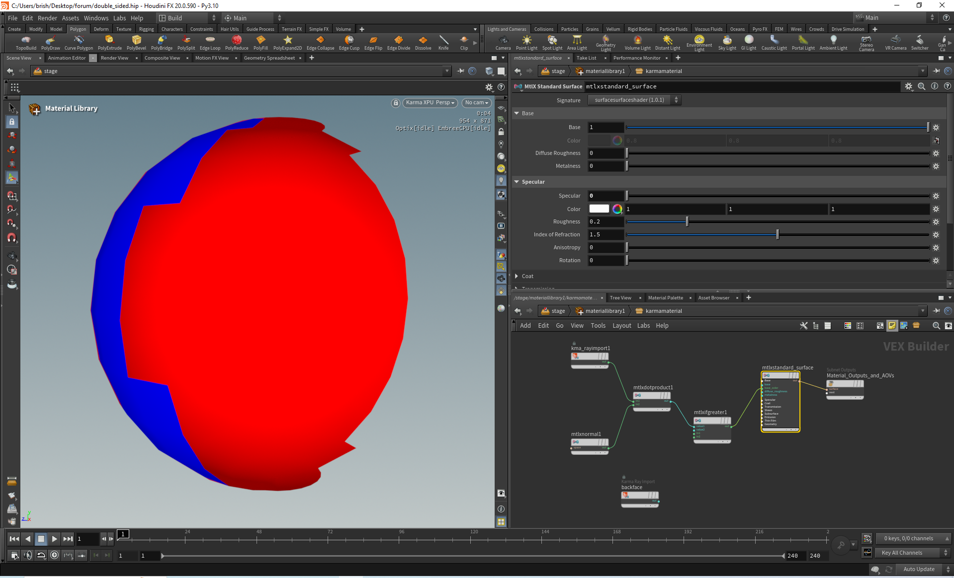

I've got it working in Karma. See attached .hip
Edited by lucap1 - May 28, 2022 00:21:03
two_sided_v1.hip (262.5 KB)

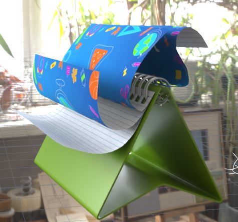

Is a similar construction possible for MtlX materials? for Karma XPU? I can't figure out how to achieve such a result.
UPD: solution that works Karma XPU with MtlX.
(Pre-create an attribute at the SOP level in the Geo node)
@N_fg = @N;
@N_bg = @N * -1;
Edited by Oleg Talanov - Aug. 16, 2022 03:54:49
