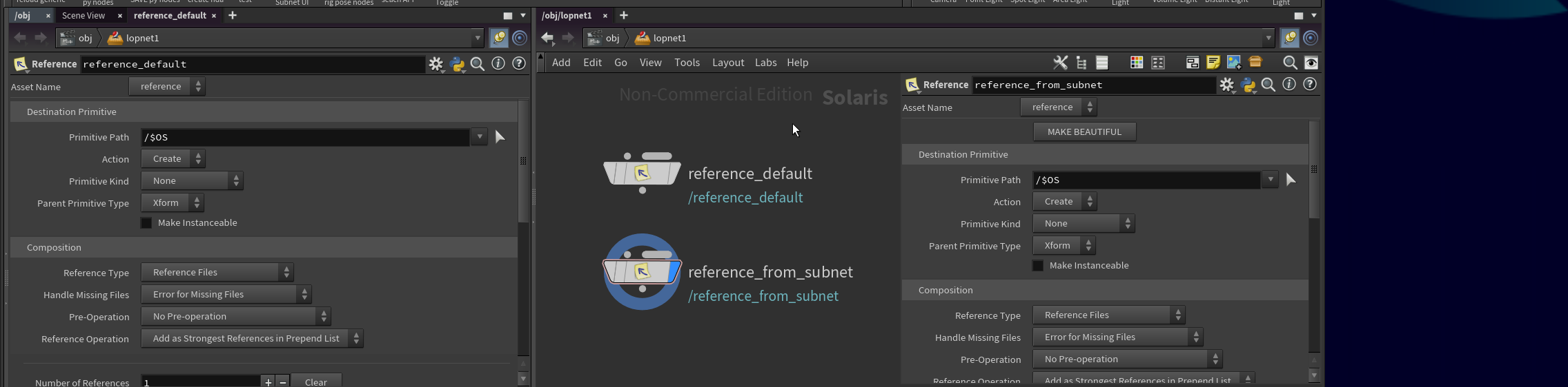

Like this?

I don't want to recreate the reference lop, just the functionality of the inputs for a completely different node

okay, well, there is no option to convert a node in the right click menu, just to change type and well, it changes the type. That's it. the image You showed earlier is show just to reference nodes. one has a additional parameter, that's it.

Ah, no have not used LOPs very much. However, I took a look at some code and there are a bunch of parms used by the reference node (in LOPs) that do not exist for a subnet and they will not merge. The Rig Pose node and the subnet are much more similar. That is why I got away with it in my case. Thanks for pointing this out.
