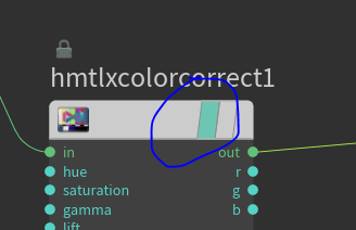

Hey,
See attachment.
I used this all the time for Redshift lookdev in OBJ. It doesnt seem to do anything for me in Lops + Karma.
Just me? Is there plan for support?

The Debug flag originated in VEX shaders to define constant outputs for debugging generated code.
For visualization, LOPs use the Visualize VOP. You can press and hold `x` then click on any node (or any output of a node) and the translated material will short-circuit the terminal shader, yielding the preview of the shader node that is being visualized.
