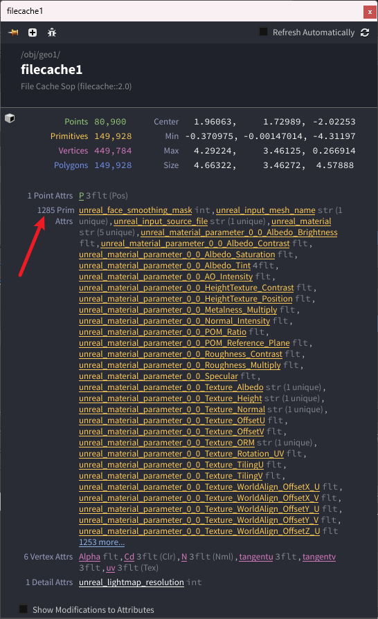

I've dug around a bit and realized the problem is caused by a very large shader assigned to the geometry. It creates thousands of parameters on the geometry, which I assume is what lags the import/export process.
I'm wondering if there's a way to not pass these through, and to only pass material assignment information pass in, which will reference the existing shaders in the scene instead (rather than baking out brand-new duplicates of the shaders when bake is clicked in Unreal).

This is all data that Houdini Engine seems to create automatically without my control.. My HDA is a simple pass-through node. It's a blank node with the input connected directly to the output.
The assets that I am plugging into this HDA in Unreal are simple Unreal Assets - StaticMeshes with some material assigned. It seems like, for whatever reason, every single parameter that is defined in the Unreal material is created as a unique per-primitive attribute when received by Houdini Engine.

You've likely hit a worst case scenario (150k polygons, and a material with 1200+ exposed parameters... that's a lot of attributes).
Tomorrow's build of the plugin has a new checkbox on inputs, "Export Material Parameters" that when disabled, will prevent the plugin from sending all those material parameters as attributes.
This should drastically improve input creation time (and memory usage on the H side) on your end.
We're also currently working on additional Houdini Engine optimizations (HAPI) with attribute creation, that should also significantly increase data marshalling times (in general, not just for this specific material parameter case).
