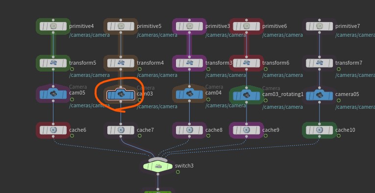

I'm wondering if there's another "gotcha" lurking around somewhere... so I've added + $F * 0 in more places than I think is needed (even after bezier(), which should really not be needed, but I guess shows I'm pulling my hair out once again). I've also added it to 'enable look at' which are also driven by curves, but just in case stepped curves for some reason weren't evaluated properly.
There's now a mismatch between "live" and cached data around frame 5970 despite me ensuring the setups for each camera are identical and curves existing on all frames. I've drilled it down to the highlighted camera's 'enable look at'. If one simply switches (using "live" data) it on and off no difference is seen. I have to remove the curve from that checkbox, and only then do I see a difference when switching it on and off. It being off now also matches the cached data.. but I of course want it on.
Are binary things like checkedboxes looked at differently by Houdini's USD caching?
It's a pretty safe bet that there's always another gotcha.
Good sleuthing to track it down to the "Enable Look At". That is indeed the issue. If you look at the Scene Graph Details, you'll see that /cameras/camera has two xformOp:transform entries for all the cameras except this one (which has a third - xformOp:transform:lookat). This in turn means that the xformOpOrder attribute has a different length from one camera to the next, but it's being authored using default values (not time samples), and so the caching can't handle this animated length.
There's possibly a way to force xformOpOrder to be time sampled, but the alternative is to ensure all the cameras are using the same number (and names) for their transformation stack.
Between the cameras and their respective Cache LOPs, you can insert a Python LOP with the following:
node = hou.pwd()
stage = node.editableStage()
from pxr import UsdGeom
xformable = UsdGeom.Xformable(stage.GetPrimAtPath("/cameras/camera"))
xform = xformable.GetLocalTransformation(time=hou.frame())
op = xformable.MakeMatrixXform()
op.Set(xform, time=hou.frame())
Give it a spin and let me know!

Gave it a spin, a confirmed two thumbs up!
I was going to ask if I could just bake the camera's xform down if the checkbox was a hassle, but seems like that is what your solution is anyway.
Just to be clear; You're merging xform:transform + xform:transform:foofoo (ie the parent transform above the camera) + xform:transform:lookat back into the xform:transform, then removing the tokens so that xformOpOrder now only includes a single token xformOp:transform - ie baking down all the transforms *per frame*.
If that's a yes from you, does that mean the previous fix of adding '+ $F * 0' to any attribute ever animated on any camera is no longer needed, seeing as the python snippet is evaluated per frame, and assumingly doesn't care if an attr is static or not?
Thanks, as always!
