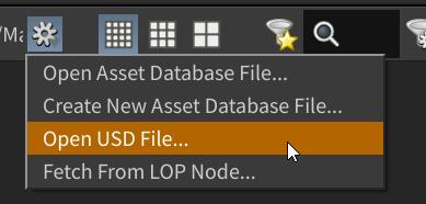

What I mean by that is when you import assets into the Layout LOP by using the "Open USD File" option (or import from LOPs).
Once you import assets through that, all previously added Assets will vanish in the Layout LOP asset selection. At first, this will keep the previously placed objects in the scene but if you then restart Houdini it will say that it can't find the references.
It would be nice if we could add assets from several files to the asset selection. If not, maybe a warning would be helpful that this action will remove all previously added items (and possibly screw up that Layout LOP node).
