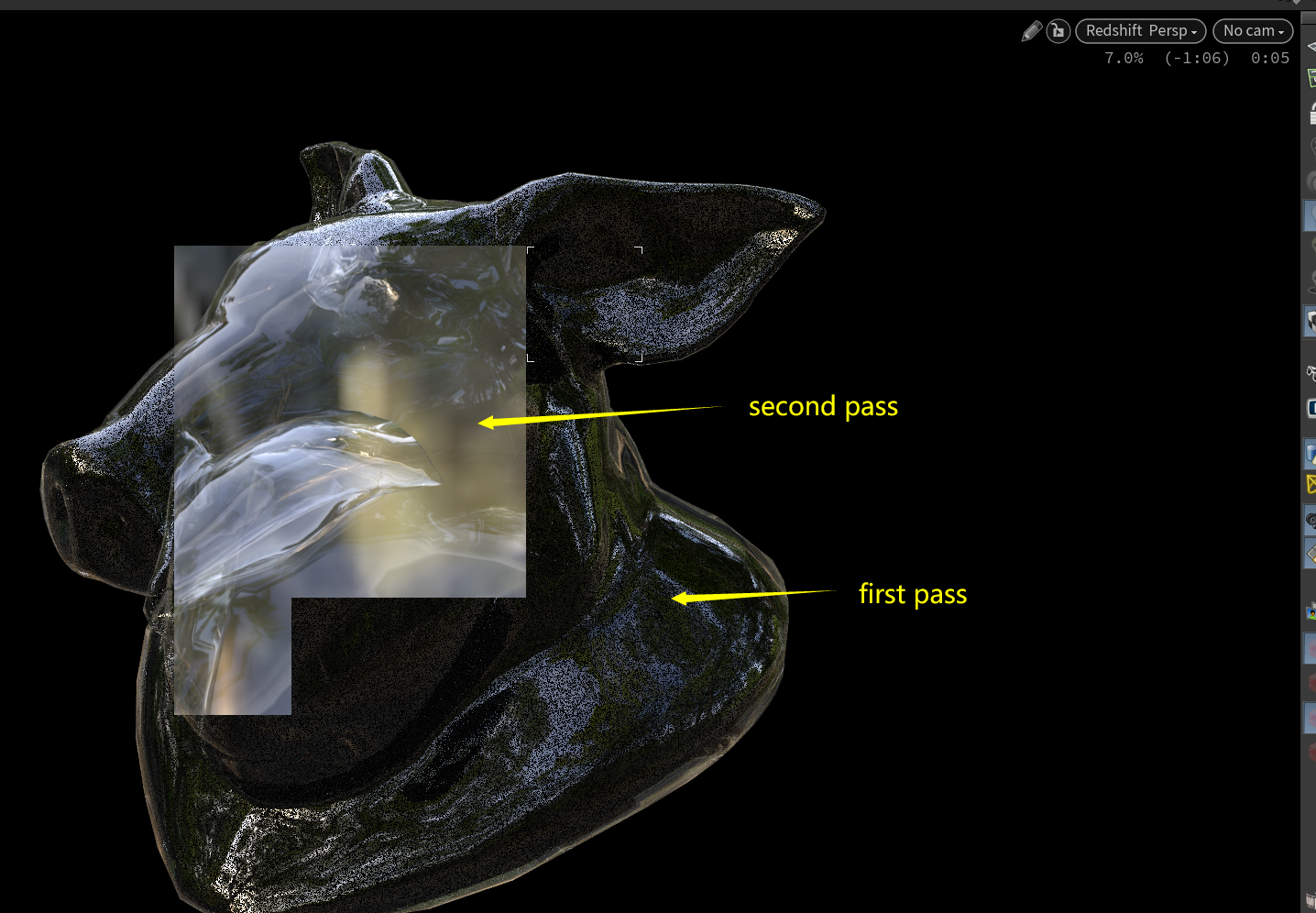

Whenever someone compare renders like these I just don't get it, what is the point you are trying to prove here?
That an almost 10 years old render-engine is faster than a not even 2 years old one?
Karma is a baby compared to how long RS has been around, plus Redshift sucked at retractions for a long time not sure why you aren't willing to give Karma the same patience. Should we compare Redshift 1 to current Karma XPU to see what happens?
I'm not saying that Karma shouldn't improve, it stills lacks a lot of common-place functionality but it's getting there and fast! also we should celebrate all the good things that's doing better than other render-engines, crypto mattes? incredibly fast to render, volumes? a breeze to setup and render, Volumetric lighting? a dream come true on how easy is it to use, Supporting USD features? better than anyone, I could go on...

fusion9
I don't have no patience. The reason of I recalling this problem is that the same problem has been present throughout mantra's entire lifecycle.
I don't want to see it happen to Karma again.
