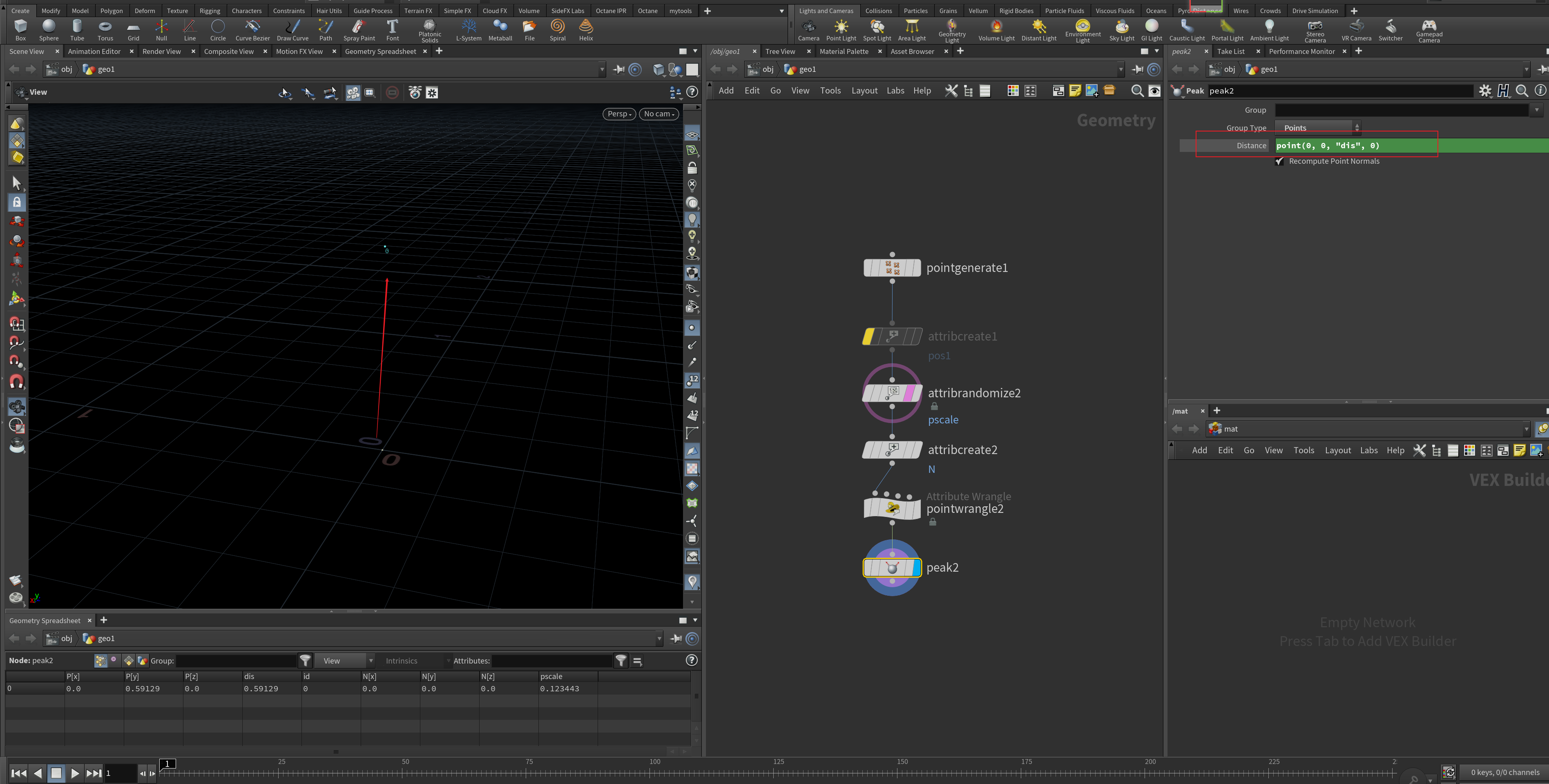

I create a attribution called "pos1", which valued 0.2
Then I wanna use it to drive the Distance of the node peak,
but it doesn't work? why?
Is that I should use the function point() ? or something else? but I dont know how to use...

Yes you have to use the point expression:
https://www.sidefx.com/docs/houdini/expressions/point.html [www.sidefx.com]
point(-1, 0, "pos1", 0)
Oh, it works~!
But to point itself,it seems the first parameter of point("") should be 0 instead of -1.
It confused me a long time because there aren't the description on how to use 0 to point to itselt in the official website .
I've successfully solve it,
thanks a lot!

-1 is for when you use spare parms so that you don't have to type which node you are referencing. If you just want to use the first input 0 is perfectly valid.
But if you need to reference the current point's attribute for each point for the Peak node, you will have to write your own peak operation in VEX.

Unfortunately,when I type -1 ,Error occured...
I seem to understand what you said.In generally, number 0 refer to the first input. And maybe it's enough.
