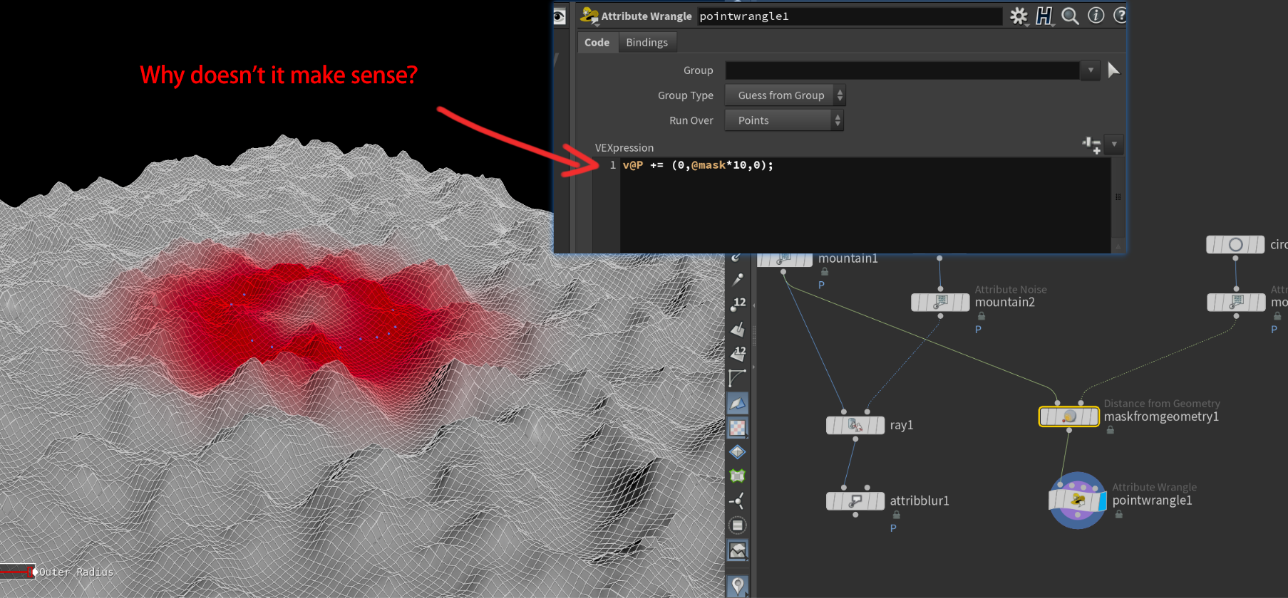

Why is it Wrong typing "v@P += (0,@mask*3,0); "?
   1147   3   0
24 posts
Joined: Aug. 2023
One simply Vex code.
It doesn't make sense When I type v@P += (0,@mask*3,0);
But it works to type v@P.y += @mask*3;
I want to know why? And how to write it correctly in the first way?

The first option will create the value of only the last element. You can check this if you write, for example,
v@P += (0,@mask*3,10);
You can see that the remaining elements have no effect on the expression.
To make it work as a vector you need to change the example a little.
v@P += set(0,@mask*3,10);

Oh, alexwheezy, thanks a lot!
It works when I use set(0,@mask*3,10);
And I've noticed that claiming a vector should use {} instead of ()
so it also work when I type:
v@P += {0,5,0};
But be carefully ,it occur an error if you reference a property @mask ,like this:
v@P += {0,@mask,0};
so in my case, the best way is to use v@P += set(0,@mask*3,10); like you say.

Yes, this form only works with literal constants. Trying to use something else will cause an error.
