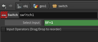

I tried using `.setExpression(expression)`, but `$F` gets converted to the frame number at the time of creation.
I couldn't input the desired `$F+1` expression directly into the parameter.

I just opened your hip file and had a look.
It looks like the exec() function is doing something here.
If you run the same script from the python source editor it sets the expression properly.
I dont have a solution for this case, but what i would do is make the subnet into hda and call the script from hda module so i can avoid the exec function.
Im too interested to know why this doesnt work when calling a script with exec() and how to fix.
Waiting for the experts!

$ variables within string parameters are evaluated so that's why you are seeing the literal value replacing your $F
if you want to insert $F you need to escape the $ so write \$F
import hou
import os
switchNode = hou.node(".").createNode("switch")
expression = "\$F+1"
switchNode.parm("input").setExpression(expression)

Thanks. That works.
