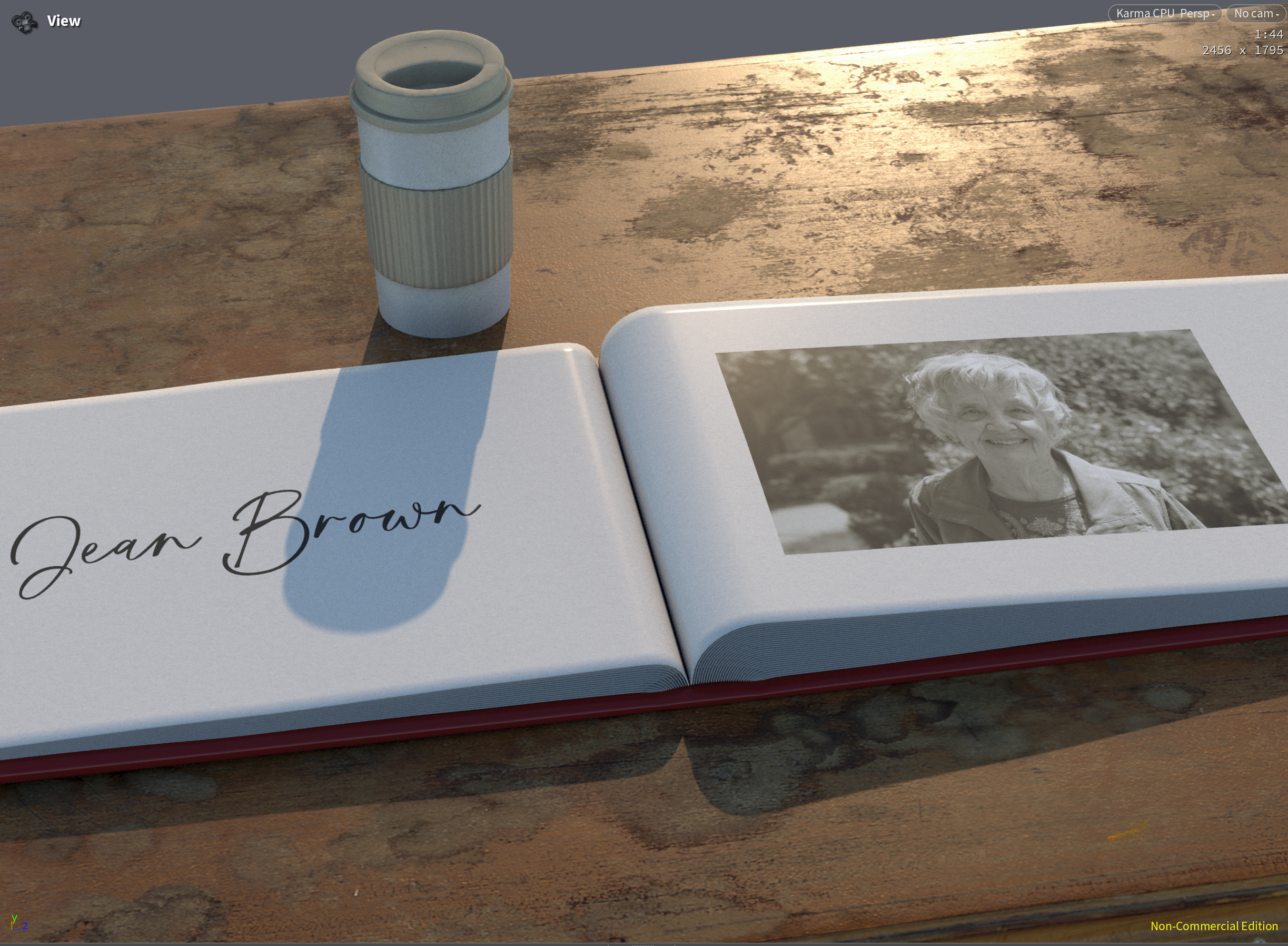

I got it working. Scene is not finished but you get the idea...
Now I just need to learn Substance painter and get some texture on the pages and create the book cover
thanks,
Dan
Right on Dan. As far as your other question, you can do two-sided materials in a Karma Material Builder using the Karma Ray Import VOP and setting the Variable Name to ray:backface. The output can then be used in a MtlX Mix node to mix between two inputs, including materials.
Though it does look like the pages have thickness? Looks like there are some normals issues with the edges too.

Thank you! This is so helpful!! I will look into this. I don't know what I would do without this forum.

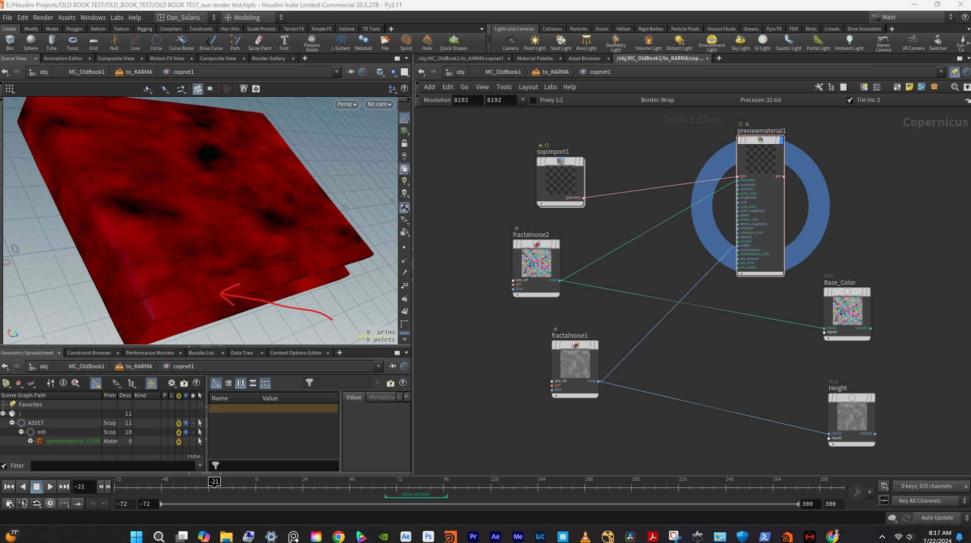

Still trying to get the normals and UVs right. There is a smearing effect on the edge of the book cover that I don't know how to fix.
I went back into SOPs and deleted uv attribute, added Labs Auto UV node set to "unwrap" and the UVs look better now, but the material still has the smear effect on the edges (see screenshot)
Also, I added a normal node at the end of the chain in SOPs (for the book cover) and that didn't fix the issue either.
What can I try to fix the normals and get this to look right? Happy to send DL link to project if needed.

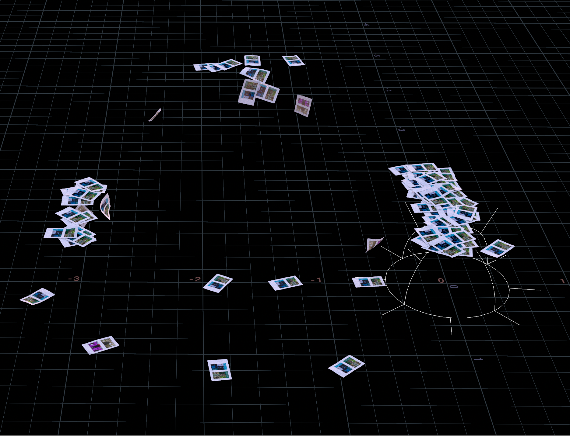

Hey guys, this seems to be the perfect place for my question.
I am also working on something quite similar. A vellum simulation that contains lots of paper sheets that are blown around in the wind, I have also partitioned my geo in the Sop-Import. But instead of assigning a unique texture to each partitioned piece of geo I want to automate it a bit. I basically want a specific primvar for each partitioned geo that contains the path to the texture. At the sop level I created a string attribute on the primitives that contains a unique texture path for each primitive (this was done with the help of the class attribute). The problem now is, that this String attribute/primvar only exists on the "parent geo" but not on the GeomSubset. In the end I would love to read in this primvar, that is unique for every geo in feed it into the file in the texture node on the material level.
I am using Redshift and would realise this via an OSL-Node called UberTexture.
Is this the right track I am on and if so, how could I get the texture_path attribute on the subsets?
