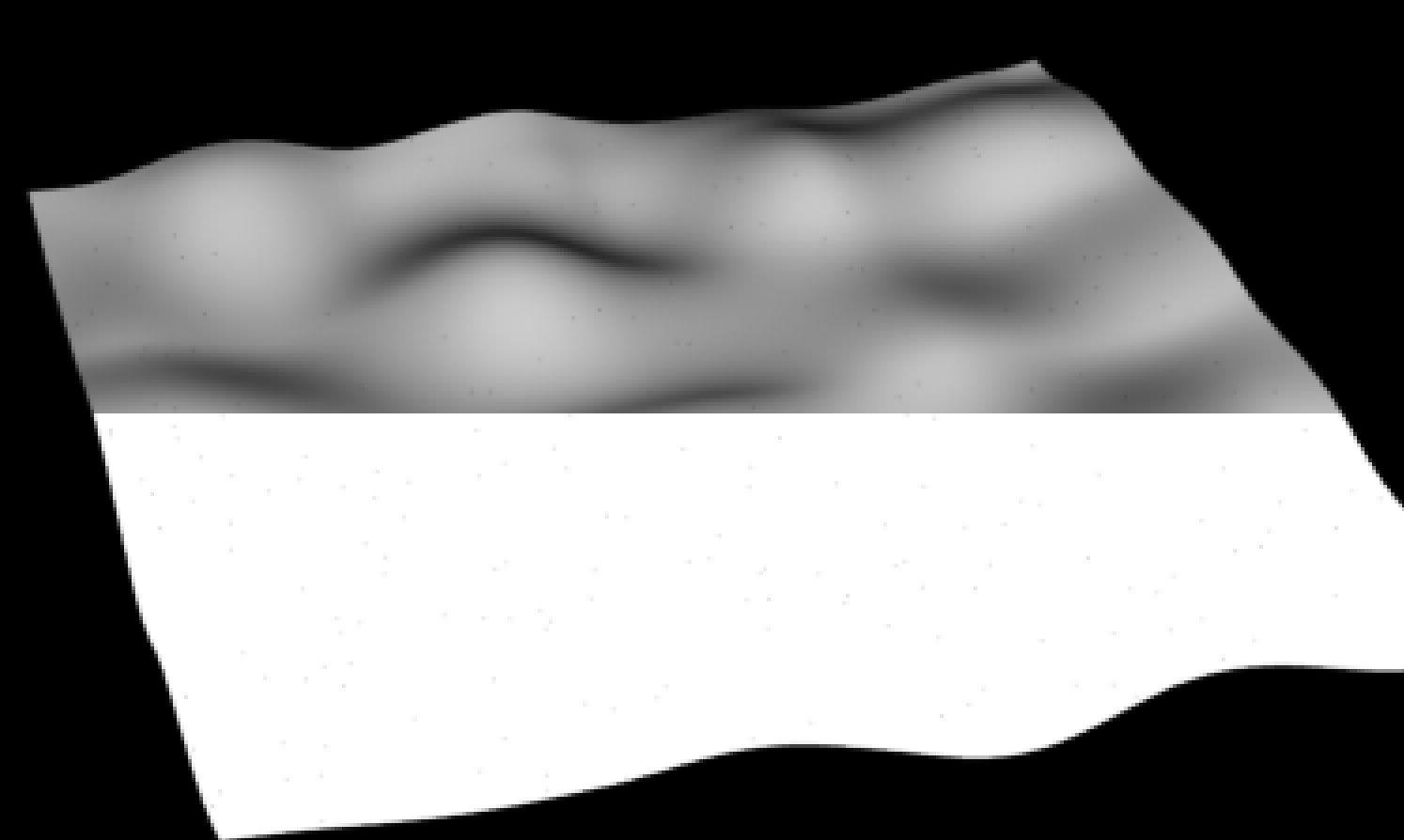

thanks andrew, but why they are there anyways?
when Wolfwood showed result from mantra H8.2 without the dots, with the same settings as in H9.5 with them?
i have a dense geometry with bad topology (many tris, different densities), but with consistent normals and without polygon errors (overlapping, cracks, duplicities …). i am using poly to subdivs and still getting those dots
i am also using glossy refractions and occlusion in some passes so the pixel samples and render quality are a big rendertime hit for me
the sample scene i provided, has 0 amount of displacement, very clean geometry and when you turn off the subd SOP and turn on poly to subd, you will still get the black dots
so can you please confirm that this is normal error with micropoly displacements and the only way to minimalise the dots visibility is increasing shading quality and pixel samples? thanks

it still doesn't solve my problem, because the black dots are still there and they are randomly scattered on every frame (because of camera anim) like noise
and when I render some 16 bit or float passes like Depth (in my project i have thickness) and then color correct them, the dots are more than clearly visible
I need to get rid of them completely
is there a reason for them to appear?
there is really no need for subdivide sop in this example, but in my project i have a dense mesh which is like the subd. was already applied, i use however poly to subd. but it doesn't clear things up

I can't get rid of black dots in render, color and alpha (see picture)
they only appear when I use displacement shader with True Displacements enabled
the displace bounds parameter has no effect on this
dots appear even if displace amount is set to 0 (see hip file)
what can it be?
Pixel samples seem to affect this, but I must set it to like 10x10 to get rid of almost all dots. In the example file it's no big deal, but in my project I render many passes with the same displacement and increasing pixel samples rapidly increases render time
Any ideas if this can be avoided by some parameter or something?
