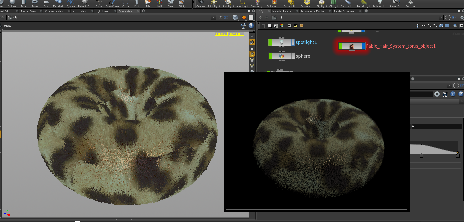

after many days and nights, after many emails, discutions, crying to the moon, etc…
thanks to everyone that helped create the tool, between coments, ideas, hints on how to do things, coworkers, the guys in the forums, Sesi, etc…
here is the first Beta!!!!
http://polybevel.wix.com/fabio-hair-system [polybevel.wix.com]
Fabio Hair System
