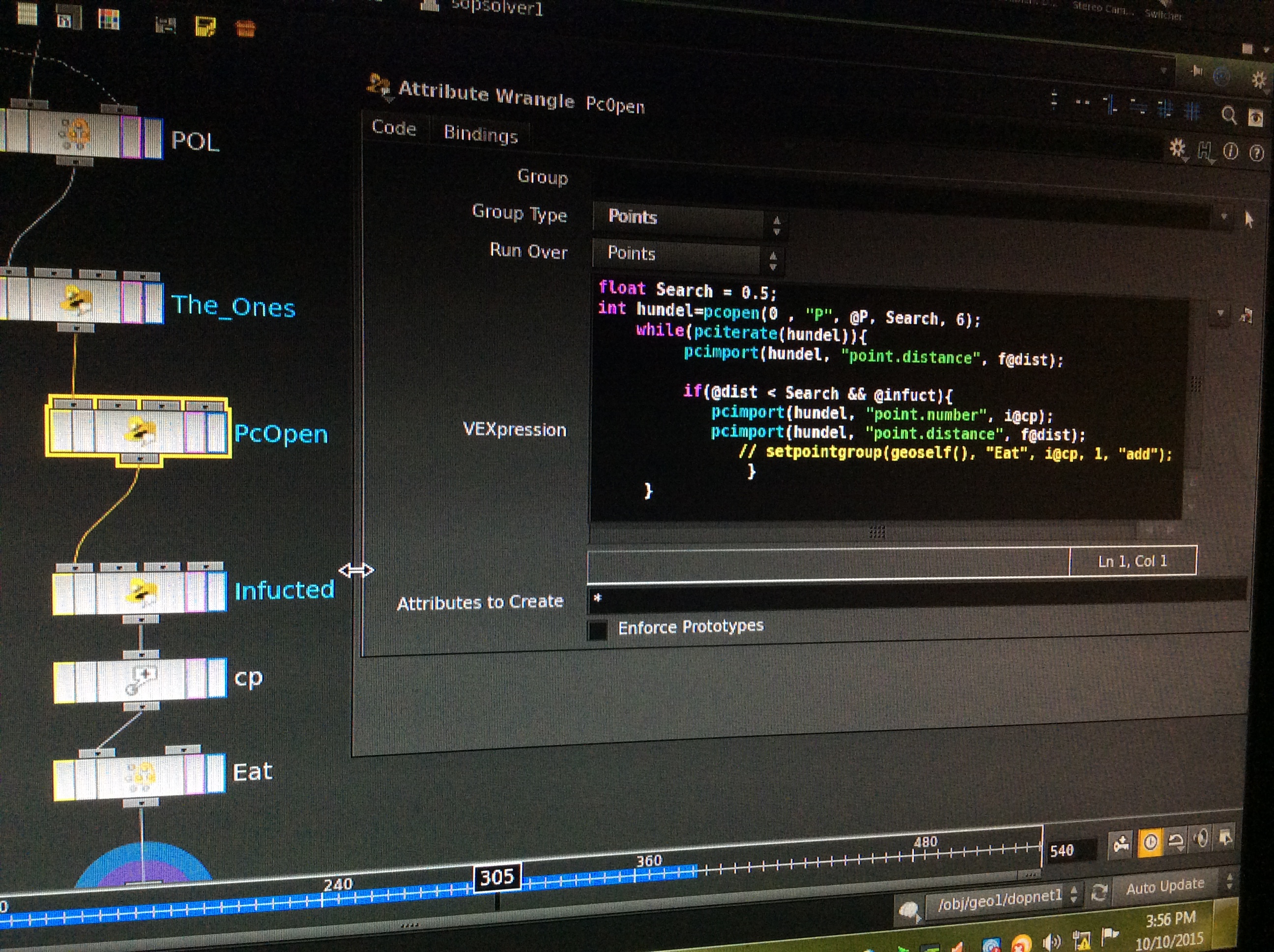

hey guys
i have simple question how i can find nearest point in vex wrangle ?
like Afaq Sabri = https://vimeo.com/119124511 [vimeo.com]

Here is my latest incarnation of detecting my nearest enemy.
Maybe you can adapt it for your use?
Don't forget to close out the point cloud after use or you may leak memory.
Also check out the Proximity VEX code inside the Crowd Trigger itself. (dive into HDA)

I did it thanks to afaq sabri and Enivob …… Thanks

as well to get just closest point you can use nearpoint() VEX function
https://www.sidefx.com/docs/houdini14.0/vex/functions/nearpoint [sidefx.com]

The remain issue is , i must move point to finde next point . that
The issue . Is there another way to do that without moving the point?
Mr . Alvaro did that with vop point cloud open node
