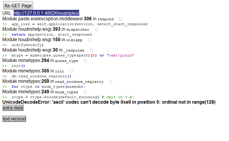

I can't download this file(some technical issues)

142 posts
Joined: 2月 2012
uhhh. not sure whats going on there…
Its literaly the first thing that comes up when you search help for fieldForce
Go to Help/Contents (internel browser) then put this into the address bar:
http://localhost:48628/examples/nodes/dop/fieldforce/fieldforce [localhost]
Notice how this is the same as the web link apart from the start.
Showreel 2013 [vimeo.com]
9 posts
Joined: 9月 2014
nope, still no result(

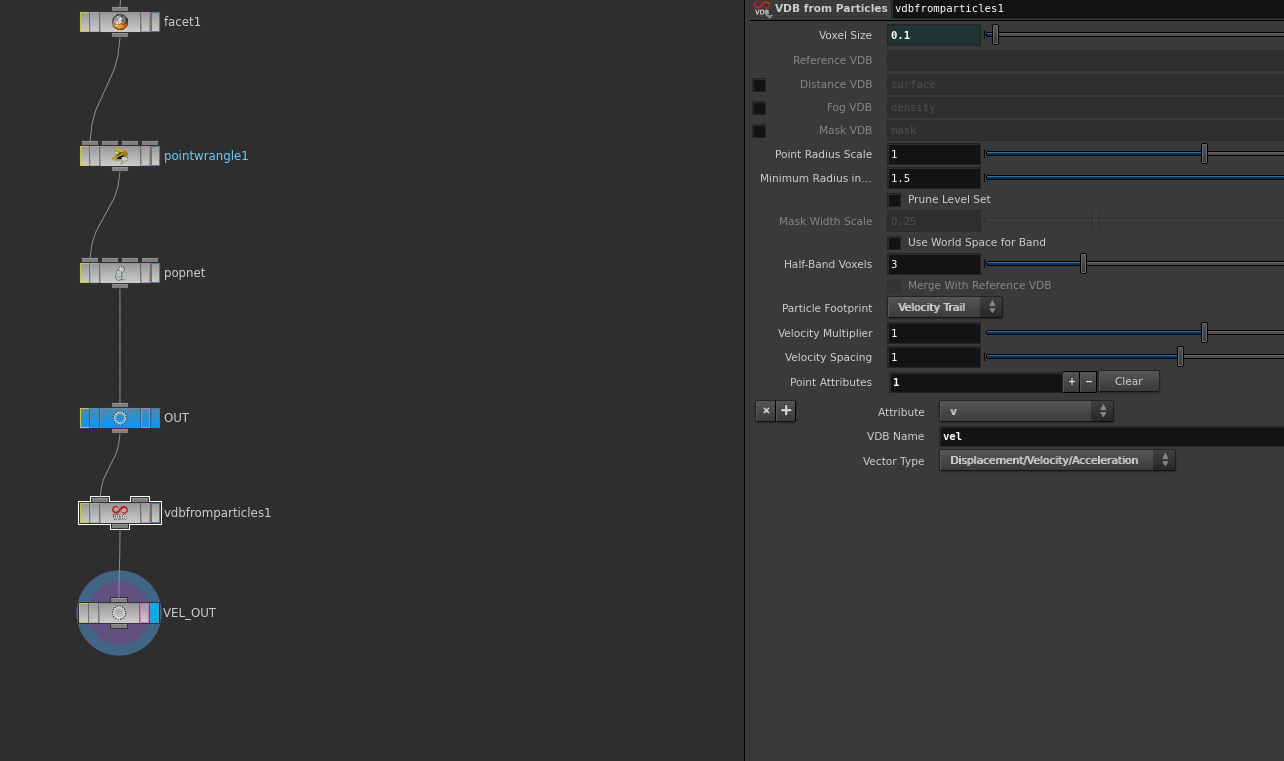

THreid to use velocity volume SOP but no result(
