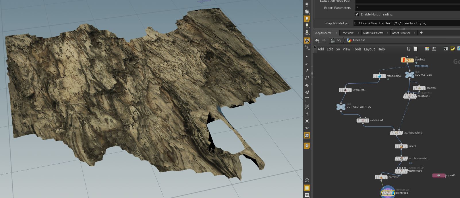

came a bit late, also its not the most beautiful implementation, but it works
this is my way to transfer color from a scanned object to the object with instantmesh applied with totally different uv and point number (it can also work with any other mesh as long its pretty much has the same form)
basicly my idea is to transfer those color from the texture map to point cloud and bake the point color on to the new uv
to get the final texture render the bake rop in the network the texture color should be in cf channel
would like to know if theres a way to improve the workflow…
best regards
Patar
transferColorFromScannedObject.zip (2.1 MB)

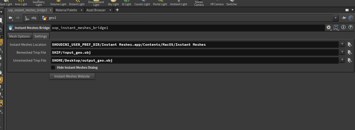

These game tools are great. I get an error message with IMB though:
Anyone else getting this on MacOSX?
sop_instant_meshes_bridge1_and_untitled_hip_-_Houdini_Indie_Limited-Commercial_16_0_705.png (80.7 KB)

Hey Kevin,
I haven't tried it in MacOS yet… If you dive into the HDA you might be able to see what the error is. Or if you uncheck the Hide Instant Meshes dialog, maybe the terminal will give you some info.

kevinthebright
I see the same issue. The stand alone works fine btw.
The HDA seems to error on line 32 of the python node in the HDA. Basically the last line.. geo.loadFromFile(out_path)

100 posts
Joined: 8月 2014
*bump*, any news here? Last I tried I was unable to get this to work on OSX. I might try replacing the $temp paths with a real path since “output” seems to be the error.. perhaps a permissions issue?
181 posts
Joined: 2月 2013
Make sure your path to the Instant Meshes application points to the actual MacOS executable, not just its enclosing bundle.
/Applications/Instant Meshes.app/Contents/MacOS/Instant Meshes
I aggree with the notion of replacing $TEMPwith a different directory.
$TEMPmaps to /tmp, but MacOS seems to prefer wherever $TMPDIRpoints to, such as:
/private/var/folders/yh/tsryfjg152138smpt90_lkdc0000gp/T
100 posts
Joined: 8月 2014
Got it working with these settings on OSX. Huzzah!

Joined: 1月 2015
Kfinla and Cyzor this is awesome thank you! …the $TEMP seemed to be the problem for mac.
