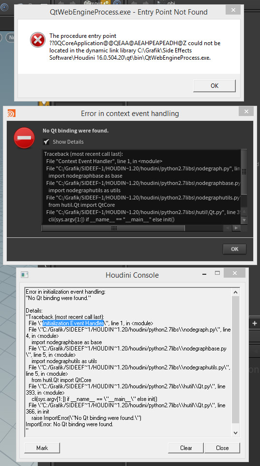

Hm - could those localisation problems be the sources of my failures too?
I use Windows 8.1 x64 in english but with a german keyboard that uses a coma as well…
I attached a screenshot of the error windows I get on start.
If I close the QtWebEngineProcess.exe window, it comes up once again and if I close it again, it crashes the QtWebEngineProcess.exe
The “Error in context event handling” I can close a hundred times, it always comes back with the same message.
Starting Houdini Indie as admin doesn't change it.
It's not the non-default installation path either, I tried an installation there as well.
The Qt4 version that was available yesterday works without this problem.

Thomas, I was just able to get someone up and running with H16 who had similar (but not the SAME) issues that you seem to have - for him it was a screwed up user account, creating a new user and installing Houdini for that one solved all his problems.
Maybe that helps? It's worth a try, if it fails, you can just delete the new user.
