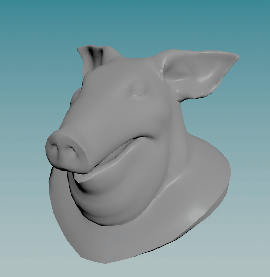

I have an iso offset node feeding into a scatter points node. I wanted to use the color attribute of the geometry node (which I had changed with a couple of paint nodes) to feed the density of the scatter points. But the color attributes are lost in the iso offset. Being new to houdini I have no idea how to get the Cd attribute after the paint nodes into the scatter points node to influence the density. Any ideas how to make this work? Thanks.

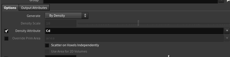

Isaac Katz
Can you explain how this would be done? I only see Generate by Density option on the Scatter node. Thanks
simple example for scattering based on color this doesnt have solution to the original post, this is just for Isaac's question

MohanpugazIsaac Katz
simple example for scattering based on color this doesnt have solution to the original post, this is just for Isaac's questionImage Not FoundImage Not Found
Thanks!! so simple
