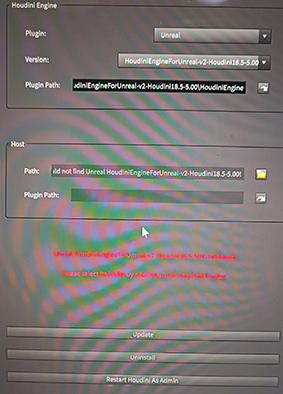

Joined: 11月 2019
Hi everyone, I need help....
I'm using HOUDINI FX 18.5.633 and UE5.
I can't install Houdini Engine for UE5. I've installed Houdini FX 18.5.633 and I tried to install different version of Houdini Engine but it doesn't work.
I followed the procedure describe everywhere (copy the plugin inside Houdini folder and copy the same inside UE5/Plugin/Runtime but, when I check inside Houdini it seams working but as I point the path folder in UE5 and install, the path I pointed on disappear with this message.....the program is installed in a protection folder and required admin permission.
At the same time, I see the Houdini Engine in UE5 but as I try to connect the session or create a new session or sync...failed.....
PLEASE HELP ME!
WHERE'S THE PROBLEM? what I'm doing wrong? see pictures below
I've downloaded:
HoudiniEngineForUnreal-v2-Houdini18.5-5.00
HoudiniEngine-v2.0.5-H18.5.759-UE5.00EA2
Thanksssss
