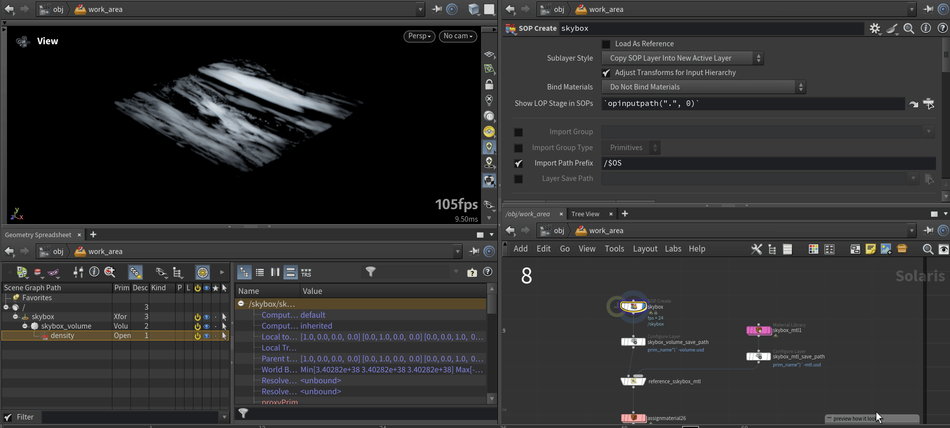

tas3d, thank you.
Visual answer for future Googlers...
Reference can be done via:
Volume LOP: ideally (i guess) for static volume.
Geometry Sequence LOP: ideally for animated volume.
Reading VDBs/USD asset comparison on a sky box:
Here's a visual addition to the answers above on how to create custom VDB save path when saving as USD
Use Scene Graph Tree to inspect if
- Geometry Sequence LOP: VDBs
- Volume LOP: VDBs
- Reference LOP: VDBs and USD asset (when directly reading VDBs, it will show a warning to use Geometry Sequence LOP instead)
- Sublayer LOP: USD asset
usdvolumesavepathattribute was created and passed from SOPs to USD primvar.Edited by AnimGraphLabGames - 2024年9月18日 04:13:08
