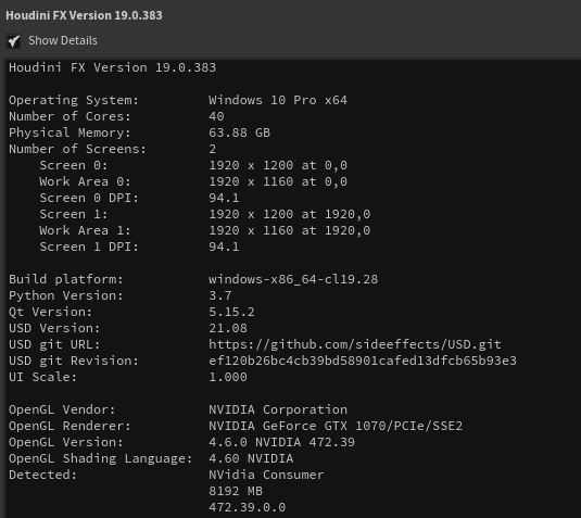

Hello MaiAo,
Nice to finally get your help on this matter
I tried to check for the Loaded Packages, I cant seem to find it.
I'll provide the snapshot of the details shown on the Houdini I'm using.
I've also tried uninstalling Labs and update the latest build of Labs too.
still getting the same error message when I hit render.
Am I doing smthing wrong? I would really like to learn how to use this amazing tool if you could help guide me on this.
Looking forward to your reply.

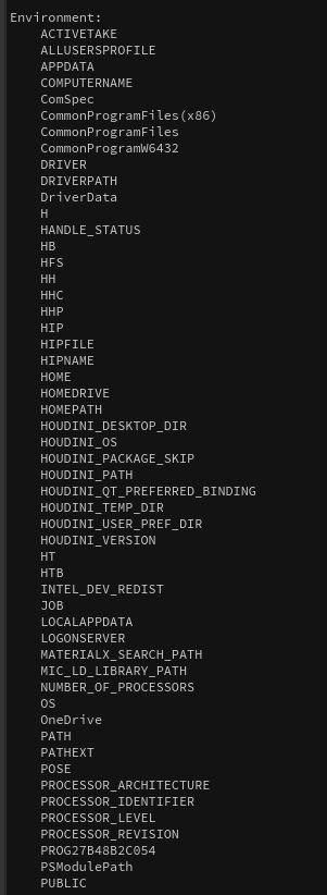

winterlang157
Hello MaiAo,
Hey, you can get to Houdini Text Port, and type
echo $SIDEFXLABS
