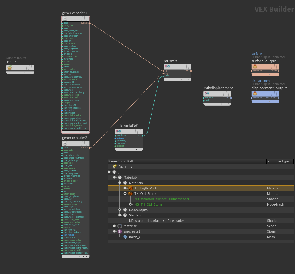

I'm now trying to import two base MaterialX materials, and layer them using a material mask (nothing fancy, just a standard material layering workflow).
I assumed the following would work - referencing the imported MaterialX materials using a 'USD material' node within a MaterialLibrary LOP - but I keep getting an error that these aren't native MaterialX nodes, and nothing renders.
Does anyone know how to do this?
image (19).png (127.5 KB)

If I try to export the MaterialX subnet directly, I get a similar error:
Shader network contains non MtlX node /stage/materiallibrary1/mtlxsubnet/genericshader1
.hip file and error file are attached

I'm currently rendering with KarmaXPU, but the eventual end goal is to get a layered MaterialX file exported for UE5, so I'm indifferent about switching if that would help proceedings....
I don't think that's going to happen. The material library makes valid USD, but isn't guaranteed to make valid MaterialX.
The Material Library, sure - but a 'MaterialX Subnet' should, shouldn't it?
(As long as you avoid the half dozen or so Houdini only nodes).
Seems a bit of a wasted opportunity if it doesn't... :S
I've not had success with the materialX subnet's output of mtlx files. In your case, there isn't a mtlx 'reference' node that would allow for indicating where an external file is referenced by the material. USD references don't translate back to materialX.
