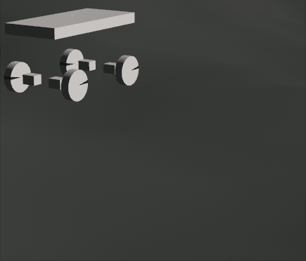

I've looked at your scene and couldn't find any relevant differences to my own scene, except for the orient attribute. And sure enough, that attribute appears to be massively important, even though you're just giving it the default value it seems.
How did you know that this is needed? It's not mentioned at all in the documentation for condir and condof.
Here's your scene slightly modified: I turned the collision shape into a regular ground plane, I added a POP force pushing the car body along X, and I deactivated the orient initialization. The result is what I'd been fighting with for days, i.e. the wheels doing weird things, ignoring their constraint directions. But if you re-enable the orient initialize, it works as expected.
So thanks of course, this is great to know! I have a feeling I'm now among roughly 12 people in the world who have this insight. Having to add 3 barely doccumented attributes via wrangles just to make directional constraints work is harsh even by Houdini's standards.

Regardless, either I'm being very thick or this gets tricky as soon as you make the rig a bit more complex. I've added a simple suspension to Tomas' example scene, and the suspension doesn't respect its constraint direction.
Each of the four wheels is now attached to the small box closest to it, using the same constraint setup as in Tomas' original scene. Additionally, the four small boxes are attached to the big box via 8 soft constraints: 4 for position (limited to the Y axis) and 4 for rotation (no allowed rotation). But it doesn't work, the Y axis limitation is not respected. The problem persists when using hard constraints instead of soft constraints.

tamteTake a look at frame 16 in your scene. While the spring motion looks great now (requiring no less than 3 constraints per spring to limit it to one axis!), you can see that the wheels are now not respecting their rotation limitation to just one axis - they are also bending inward.
and here is the fixed suspension
In Blender or even Unity you have a series of checkboxes that you can untick in order to limit a constraint's freedom of movement or rotation, and from what I've seen that actually works.
To get spring motion along just the Y axis, in Houdini we now had to add:
- a position spring or hard constraint whose @condir is set to Y (condof 2)
- a position spring constraint with free movement
- a rotation spring or hard constraint with no movement
And having made these additions, now the wheels don't respect their rotation limitation anymore.
I think next time I need a vehicle rig I'll do it game-style, with raycasts against the ground and calculating the forces in a SOP solver myself. But this whole thing really makes me wonder whether the internal code is broken somewhow.
