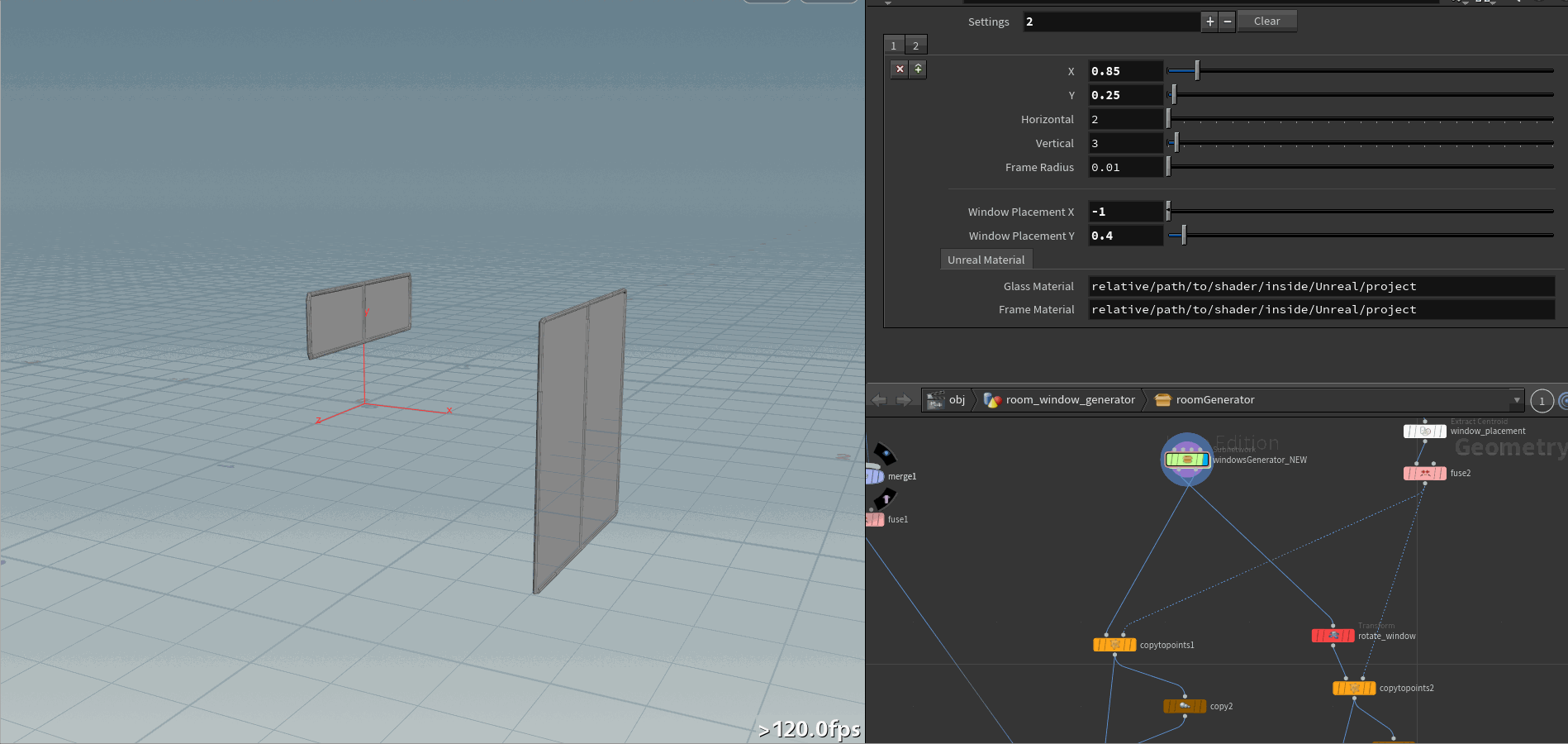

I have a For Each that doesn't have an input, I'm creating geo with "Multiparam block (tabs)" (parameter interface). Then modifying geo by accessing the current iteration number and concatenating it with multi-param block parameter(s) like so:
ch(strcat("../<PARAMETER_NAME>", detail(-1, "iteration", 0)+1))
Current difficulty: can't move objects separately after 1 iteration. An object after 2nd iteration will move an object from the 1st iteration. I want to move them independently (manually).
Example (desired result): create the first object, and move it. Create a second object, move it independently from the first one, and so on. Make sure that both of them are merged at the end. All of it is inside For Each loop.
Basically, create objects inside For loop and move them independently.
Expected VS current result:
Tried this VEX to try my assumptions(probably missing something fundamental):

Parameters (just in case):
For each loop (just in case):

Hey Oliver, thank you for your response!
I actually want to do the opposite of randomization 🙂 I have added another GIF example (the last one) where I've shown the current behavior.
The first frame moves independently from the second frame, but the second frame moves the first frame as well. The current difficulty is I'm not able to move the second frame (or any other after the first frame) without affecting the position of previous frames.
Hope it makes sense.
Just in case, by frames I mean window frames🙂

I would put the wrangle at the end just calling placement_xy+itoa(i@id) or something.
roomgen_forum_mod.hipnc (310.0 KB)

Aizatulin
Very interesting. This is pretty much what I was trying to figure out and solve. Grateful🙂

Aizatulin answer [www.sidefx.com] worked for my case 🙂
Block Begin:
Block End:
Also, where is your window placements coming from?
Kind of difficult to explain by text 🙂 Basically I get walls -> extract the centroid for each prim -> specify on which wall to place window(s) (only 4 options as only 4 points present: 0,1,2,3) -> copy to point -> change window placement if needed (manual, issue I had) -> add an additional window on the same point and modify its position. Hope it makes sense.
