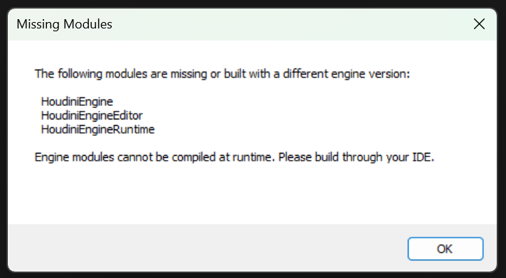

Hi, I tried to install the Houdini plugin for Unreal 5.5.4, but it shows this message when I open a project.
In the *C:\Program Files\Side Effects Software\Houdini Engine\Unreal folder*, I can only see the newest Unreal version, but not the 5.5 one.
I copied the file to *C:\Program Files\Epic Games\UE_5.5\Engine\Plugins\Runtime*

We only support the latest two versions of Unreal - so at the moment, Houdini ships with binaries for 5.7/5.6.
You cannot use binaries built for either 5.6/5.7 with UE5.5 - the only way would be to build the plugin from source.
If you can't build from source - you should use an older version of Houdini that shipped with the UE5.5 plugin.
It seems that H21.0.512 was the last one that had UE5.5 binaries for windows.
