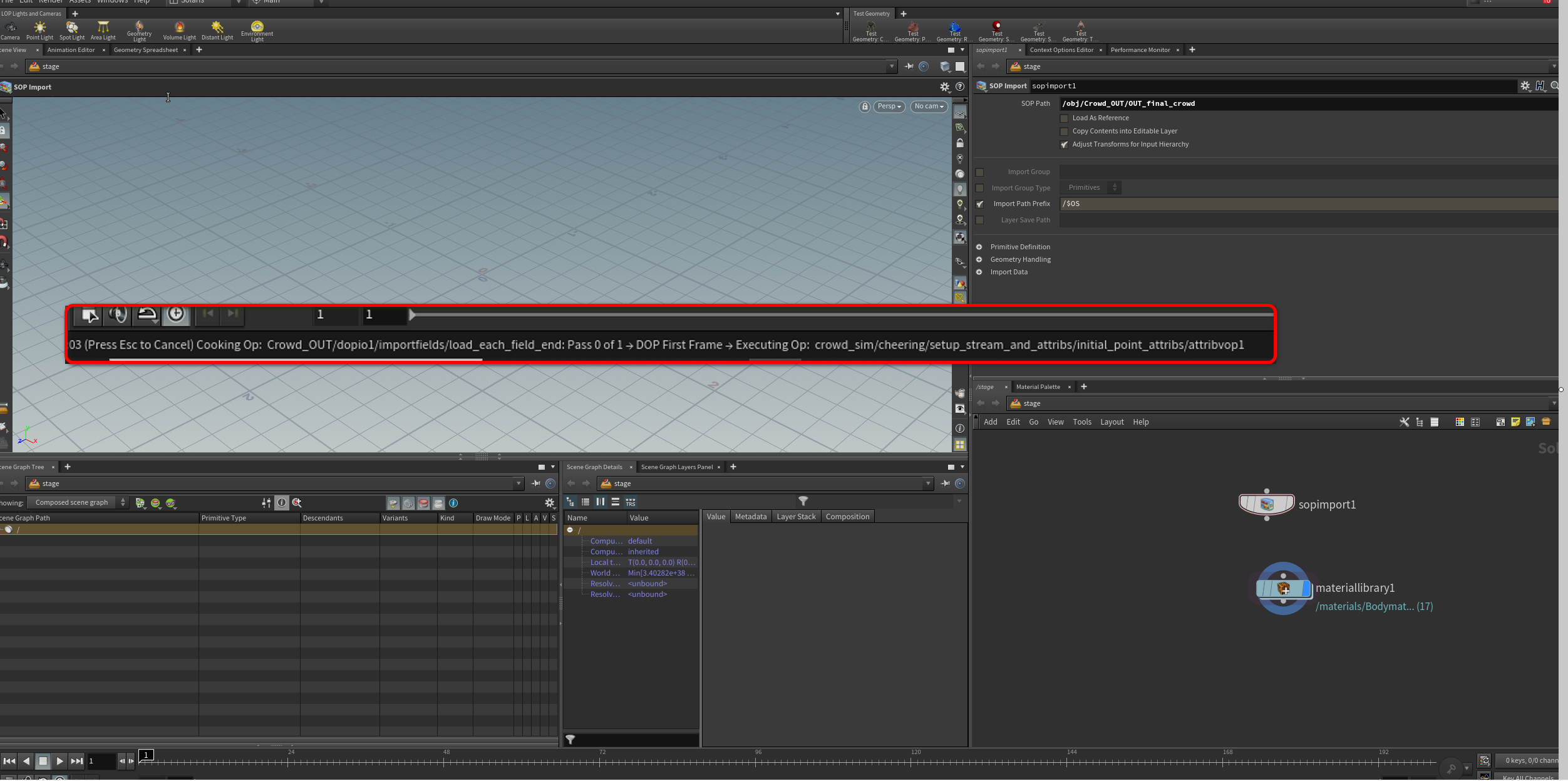

Hello,
I set up a scene with crowd sim and a simple enviro, Solaris makes houdini crashed when I tried to a agent output in the SOPIMPORT....
Houdini crashed with also with a lower amount of agents (150 agents).
How can I solve it?
Thank you for your support;

mtucker
Thanks very much! I have reproduced the crash and submitted a bug for it.

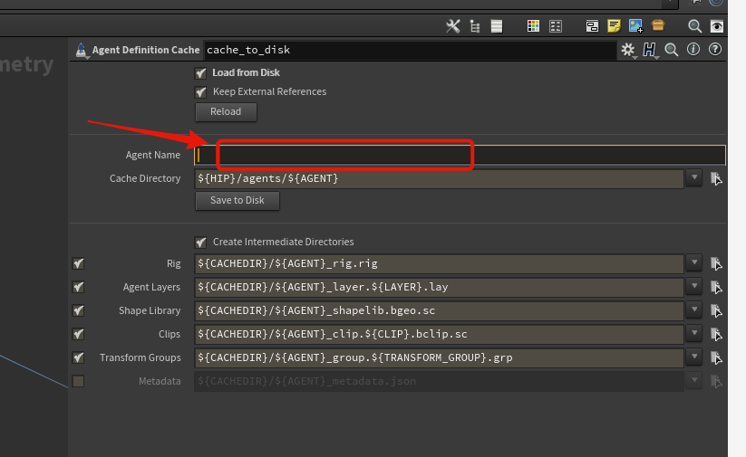

cwhite
The crash should be fixed in tomorrow's build.
It was related to having an empty 'agentname' point attribute on the agents, which is used to determine the USD prim paths for the agent definition. You could fix that by adjusting the parameters on the Agent Definition Cache SOP

Thank you for helping me, How can I do it? Do you have a print screen? "which is used to determine the USD prim paths for the agent definition. You could fix that by adjusting the parameters on the Agent Definition Cache SOP"
Just writing a name agent here?
I TRY IT AND IT WORKS!!! THANK YOU

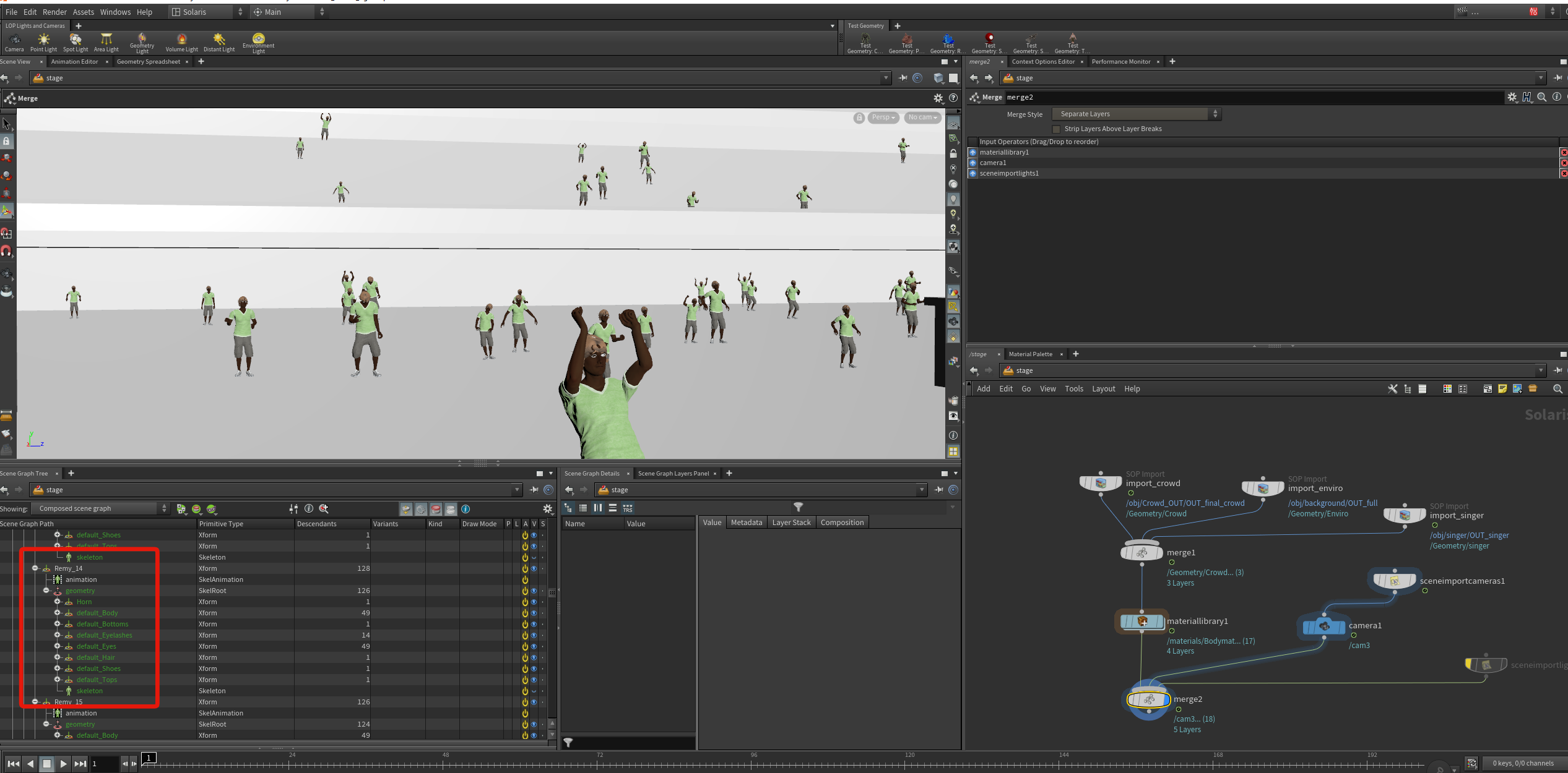

I set up my scene with Solaris and I tried to render with Karma (only 150 agent) but nothing happen....And then the file crashed, I can render the background but the problem is the crowd sim make houdini crashed. Should I cache the sim crowd?
cwhite
Sébastien Levieux
Correct, you just need to update that Agent Name parameter. It looked like it was referencing a parm from a node that no longer existed, so was evaluating to an empty string.

Yes, The render is slow and crash when I display the agent sim....
Sebastien Levieux
Also, I have no layer imported... this agent number 14 should have a cap..
The render with karma is very slow to update with 150 agent, with all the crowd houdini is not working.
