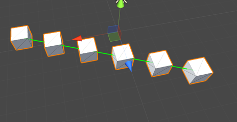

Try out the CurveDecorator in <Houdini Install Path>/engine/unity/Assets/OTLs/Samples/CurveDecorator. It takes in a curve and an instance object. When you bake it out (optionally don't have to bake), it produces individual meshes under the instancer child gameobject in the prefab.

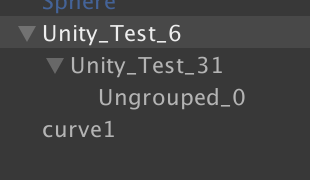

Thanks seelanv but I'm having a bit of trouble reverse engineering that scene
If I create my own curve in the instancer it doesn't work, also how does the instancer know to use the xyz instance geo? I cant seem to figure that out.

Try the following steps in Unity:
1. Place the CurveDecorator.otl in the Assets folder in your project.
2. Drag & drop the CurveDecorator into the scene. It should automatically create a curve, along with transform handles for each point on the curve.
3. Create a sphere or bring in your own mesh into the scene.
4. Drag & drop that sphere into the Instance_Object field on the Houdini Instancer Manager component that is part of the CurveDecorator game object. See screenshot red box.
5. Optionally, create your own curve from Houdini Engine -> Create Curve. Then place that as the reference curve on the Path Object field in the Houdini Parms component on the Curve Decorator game object. See screenshot green box.

I can use the asset fine in Unity but I cant seem to create my own HDA in Houdini that will instance objects to the path. I just cant seem to figure out the instance node.
It doesn't seem to work if I use my own curve (in Houdini).
Also, how does it know to copy that instance object to the curve? I cant see any reference in the instance node parameters.
