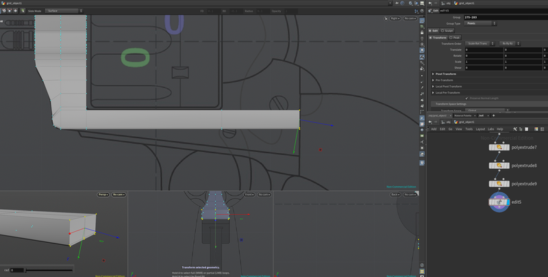

Hi, I got a bit of a problem at hand. As shown in the following picture, the move often tho not always not alligned with the world nor local. I am sure there is a reason so I thought I ask. Thanks in advances. -Iris
toonafish
You probably already figured it out , but just in case : RMB click over the Gizmo > Align Handle > take your pick.
tamte
also notice that your collapsed Pivot Transform section is bold, meaning it has non-default values, expand it, zero out Pivot Rotate and see if that helps
