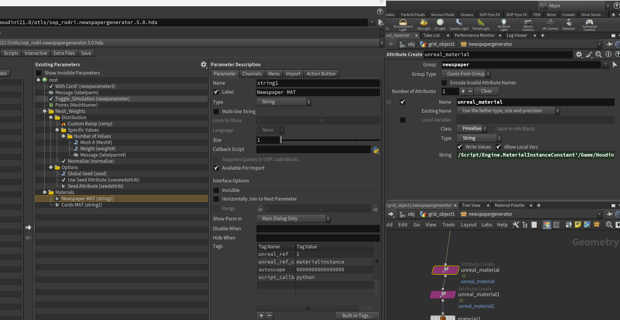

-The simulated meshes are overlapping a bit ¿how can i avoid that?
-For some reason my material now is a flat white color.
Your help is proving invaluable; thank you very much.

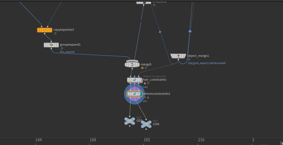

road_to_cga
At this moment i can't continue cuz i've set up two simulations one after another and the second one doesn't work.
The first simulation is building the pile of newspapers and deforming them and the second should wrap a cord around but doesnt work

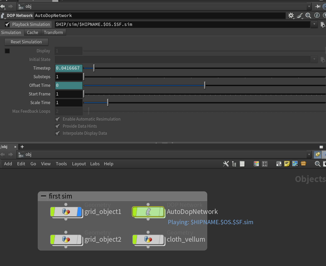

The first simulation is basically this:

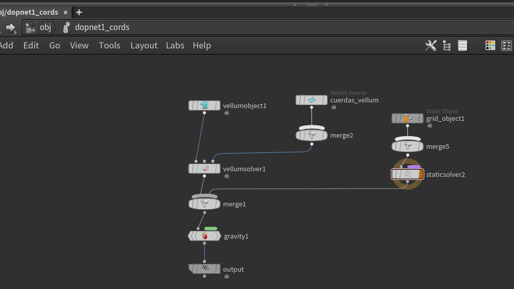

And the second simulation setup is...
I would greatly appreciate your help.
