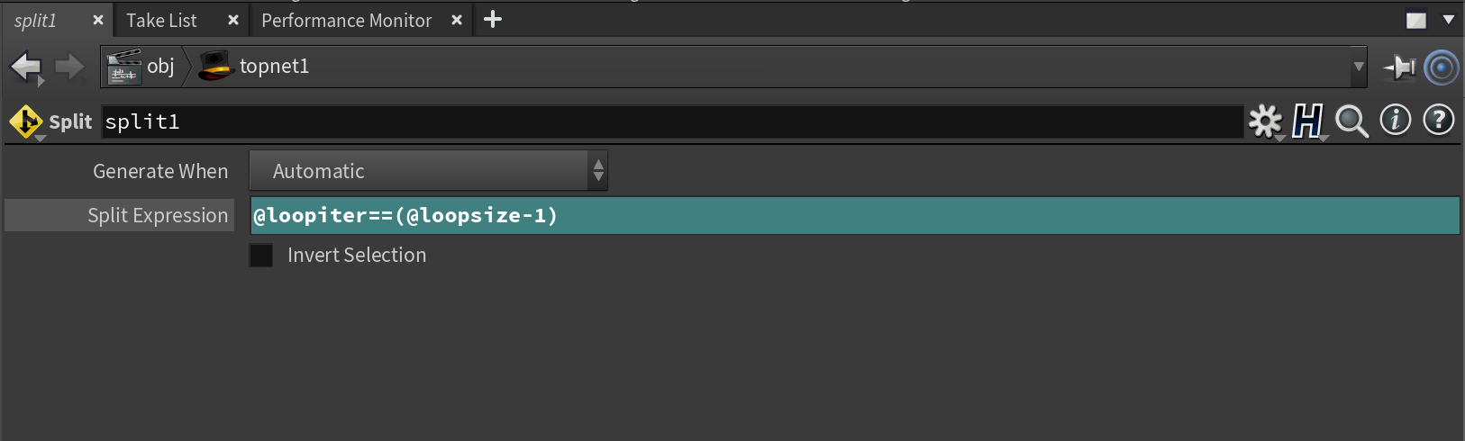

peterbengtson
This works, that is, using a split node to select the last work item:
... using a Split Expression like so:
But is that really the most idiomatic way of selecting the results of the last iteration?
