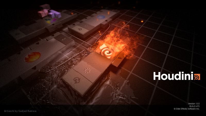

I made all needed setup to achieve good fire in my last post for you . :?
I used same setup for my personal project in the H13 Splash Window Contest !
To Render Alpha Channel you have two way :
1.use fire_mask Image Plane (exactly like Skybar post)
2.Make some simple changes in the fire's shader to render fire_mask in the standard Alpha Channel .
I made this 2 steps in the attached project with detail notes
Also I made simple Nuke project to use Alpha Channel in these 2 method for you 8)
