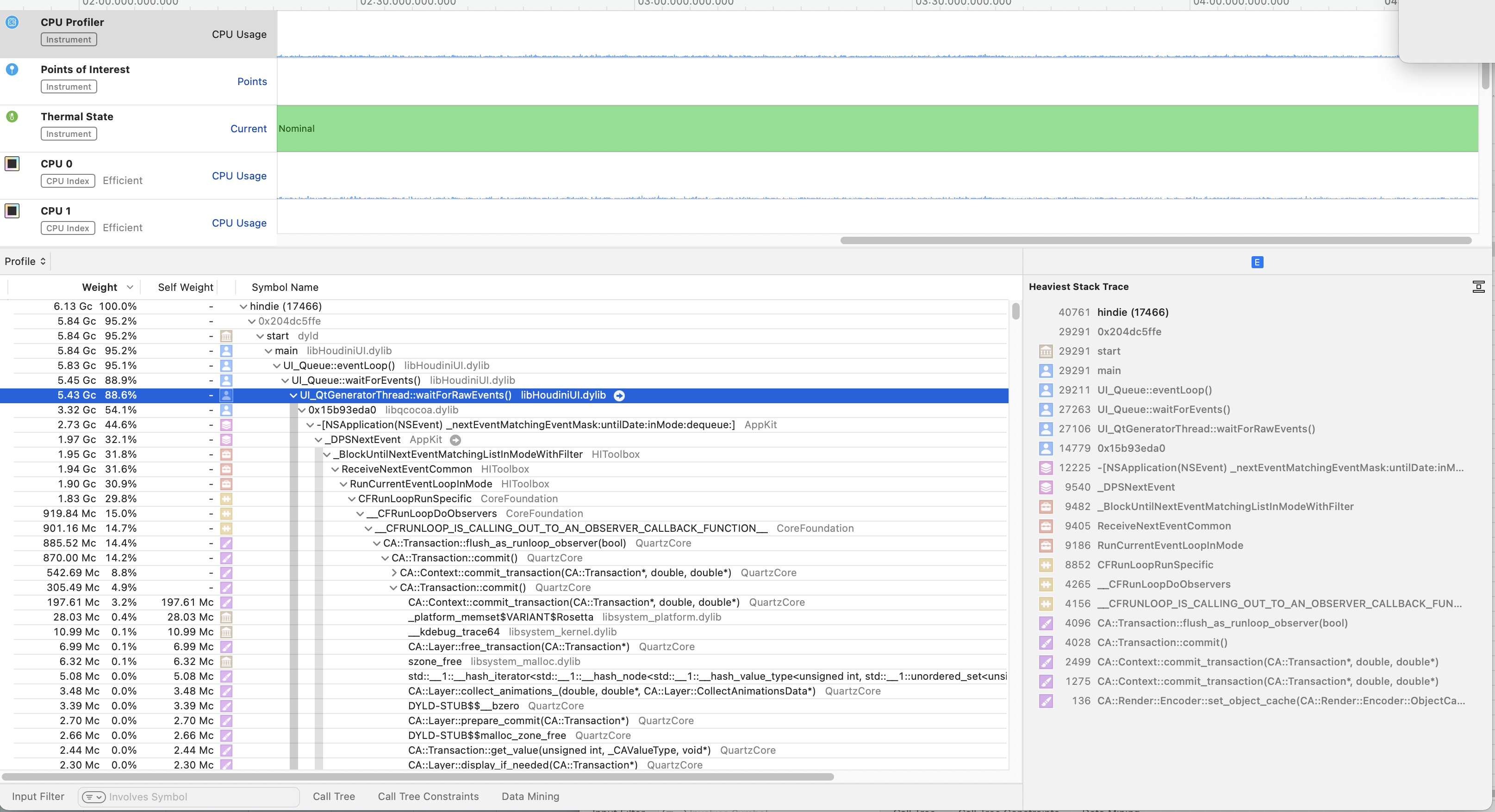

Hi Rob,
I tried to set HOUDINI_DISABLE_BACKGROUND_HELP_INDEXING=1 but no success.
I suspect there is something going on with the event loop because if I use Houdini for 10 minutes and let it idle, it consumes a large chunk of CPU (25%) for the hindie process and 50% for the WindowServer process (Quartz renderer on macOS).
If you look at the Stacktrace, it continuously send message to the CA::Render even if Houdini is running in the background. That makes me think it keeps sending draw calls for some reasons. I compared to Cinema4D and Blender and I don't see these constant draw calls there.
Attached is the instrumentation.
Thank you

jd_m_007
Hi Rob,
Thank you
Thanks. It's very possible that it's a redraw issue. I'm not ruling anything out. The call tree identifies the event loop as taking up majority of execution time but that's expected since everything runs through Houdini's event loop. It's interesting though that CA::Render is in the heaviest stack trace and that your CPU is pegged at 25% even when Houdini is idle. That's definitely not expected.
