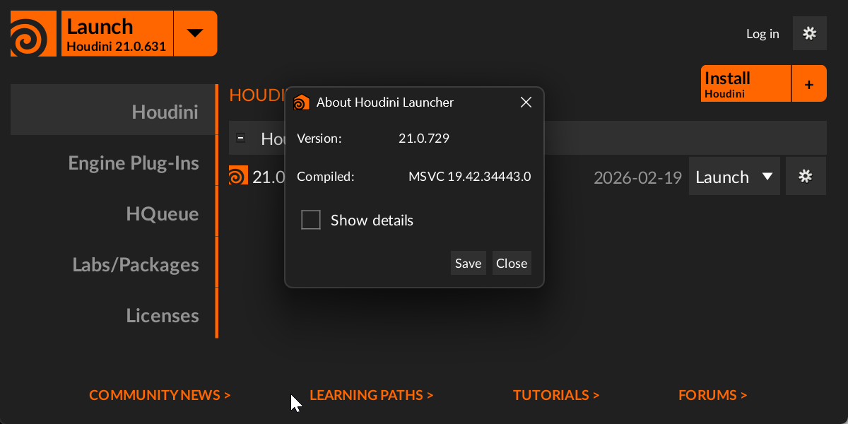

This issue is driveing my creazy I check the server is working but I can't updete houdini to the new virson I keep gitttng this message Something went wrong connecting to hserver: Could not connec
