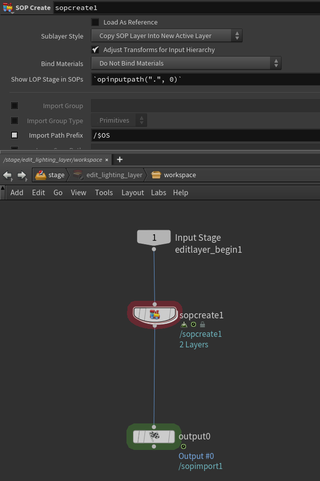

Just to add to this - this setup below works using the usd rop node, correctly sublayering the sop create that was cached out to test_v1.usd into the shot usd.
This same setup, when using the shot output node, outputs only the light primitive to the shot usd, and ignores the sublayer entirely. This seems to lead to something being misconfigured with the shot output node, but I have no idea what that may be

sopcreate defaults to creating a new layer. From the Lop nodes, you can see that it's a different color.
Switch to sopcreate> sublayer style> Merge Sop Layer into Exisiting Active Layer
And that will bring the new geom into the layer you are editing to publish.
You can also see those layer modification in "Scene Graph Layers" panel.
