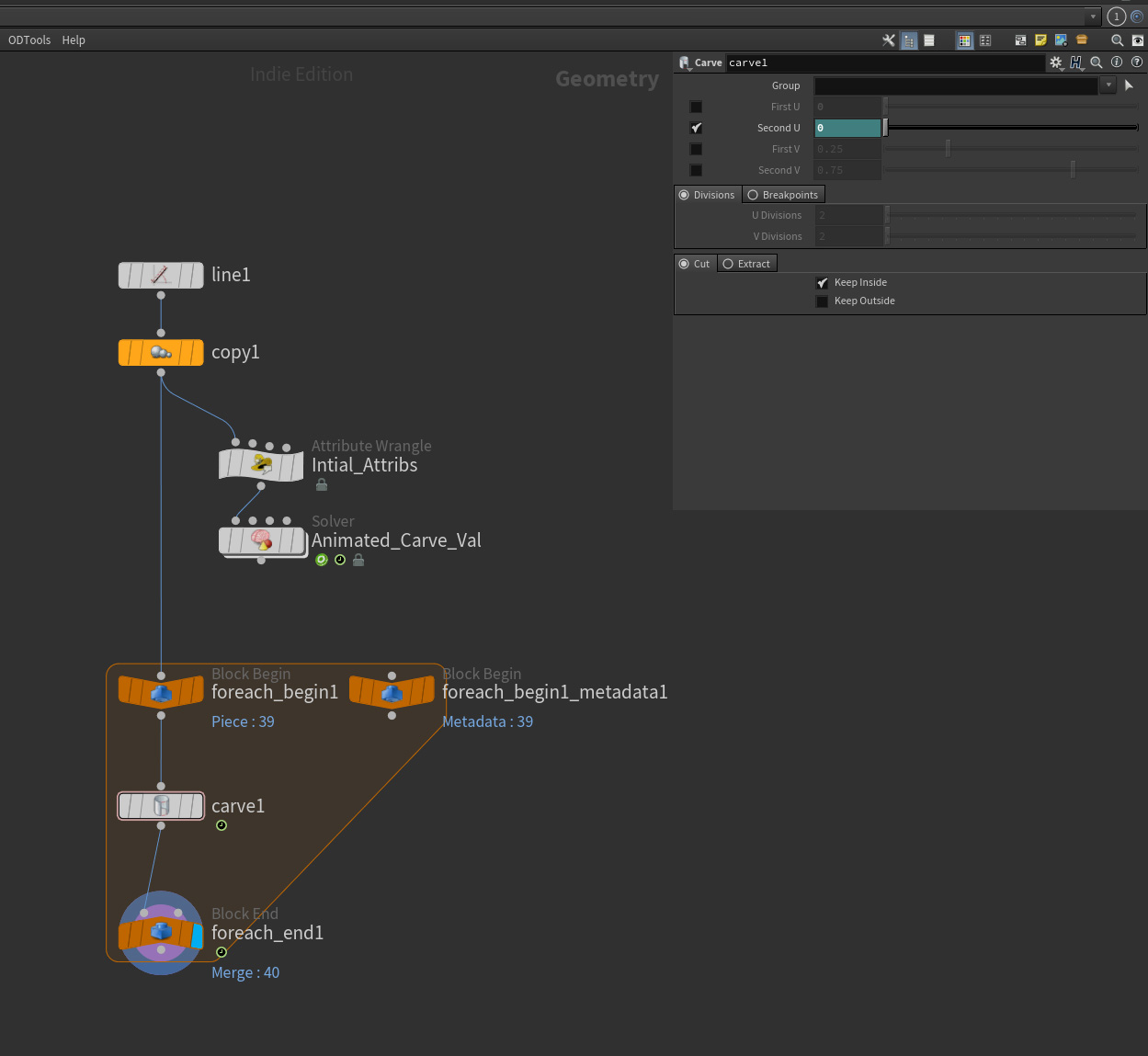

There was post last night asking how to offset the Carve U channel so that it grows on one by one for each prim overtime.
I did the attached as how id do this but didnt get chance to finish and post. I think ive over complicated it and wondered if there is a much simpler way?
(The original poster must have figured it out as I cant find thier post now)
Growth.hiplc (158.0 KB)
Love Houdini
152 posts
Joined: 8月 2012
I gave it a go
time_offset.hiplc (98.1 KB)
