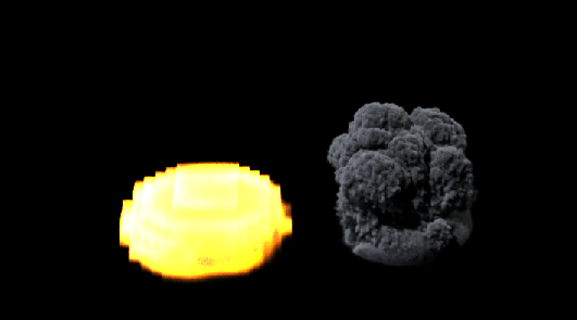

Another issue crept up though: While the fire simulation looks fine, the render of it seems cut-off or something else went wrong (see screenshots). The smoke sim, though, looks fine in the same render…any ideas?
