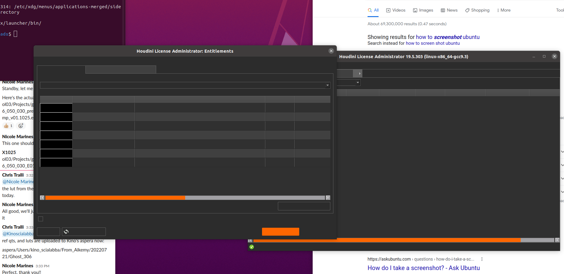

license manager on ubuntu 20.04 is blank
1178
3
2
trying to install my liceses but the ui is just blank any ideas?

Same thing happened to me. I contacted support and they emailed me new licenses. I manually installed. It bypassed the blank license manager.
also try:
$ cd /opt/hfs19.5.303
$ source houdini_setup
$ hkey
Edited by alunablue - 2022年7月21日 23:36:15
Same happened to me when I started the License Manager from the Launcher. (Linux Mint 20.3)
I then started the License Manager from command line and it worked (without sourcing houdini_setup).
Edited by Steffen Dünner - 2022年7月22日 04:57:26
thank you that worked .
