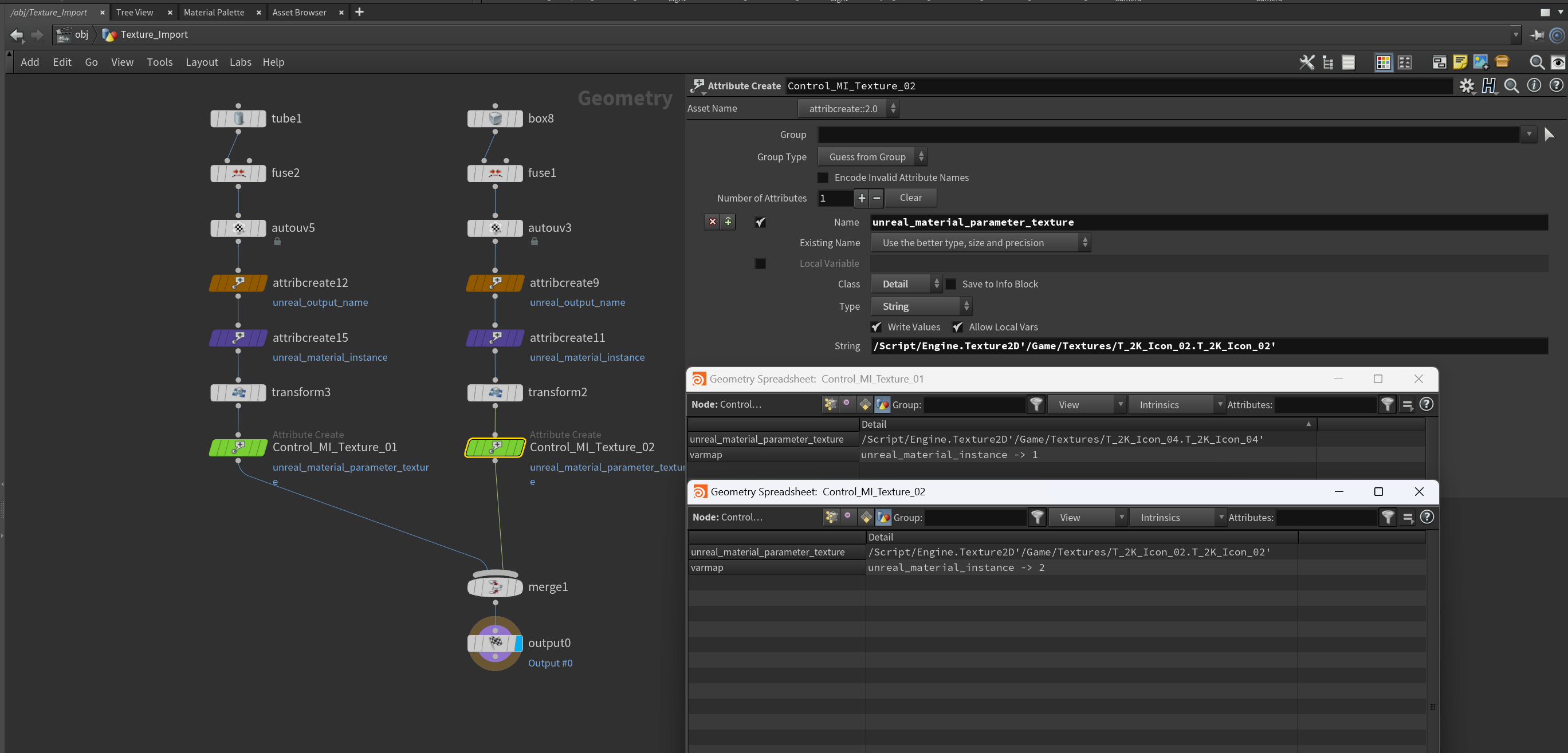

I've been struggling with the topic of this thread as well, but the work around is to set random parameter of Material Instance (hereinafter referred to as MI). Imagine, you have 2 packed primitives. You need to set up different MIs of one Master Material. In order to get two different MIs, you should set parameter to a different value, i.e. parameter Roughness. One packed primitive will have value of 0.75, and another one will have 0.76
You can do it with
unreal_material_parameter_roughness
if your MI has parameter with the name of "Roughness". Read about this in the documentation.
Also I found out, that those attributes can be placed inside packed primitives and Unreal will find and read them afterwards
