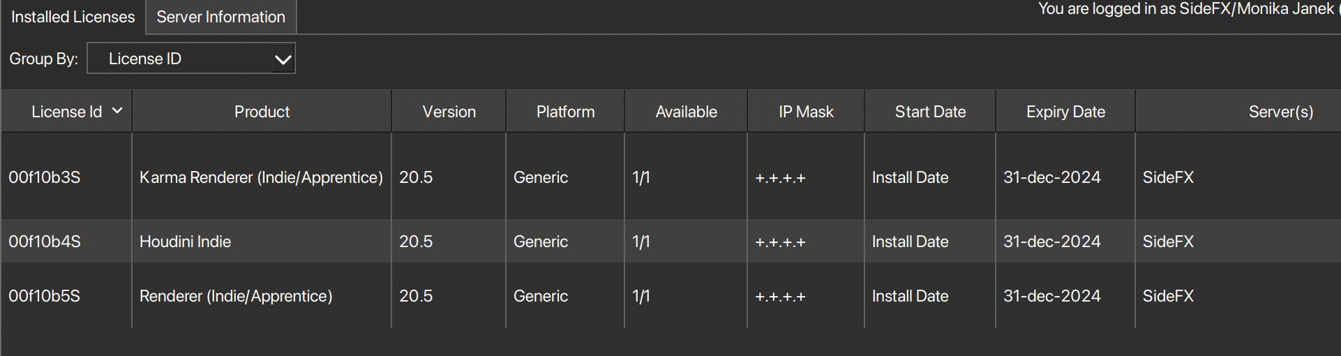

Using the License Administrator (hkey):
  1. Select File->Log In to log into your SideFX license account using your email address and password.
  2. Select File->Use SideFX as my license server
The Server(s) column should list SideFX if you are using SideFX as the license server.
