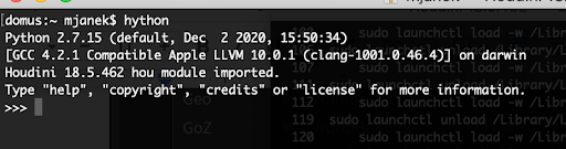

  2. Type the following command: hython
  3. You should see the hython command prompt if a license checkout has been successful.
For example:
Hython License Test
