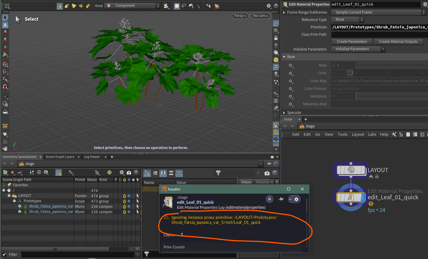

I'm currently working on authoring bunch of assets from fbx to usd to later move our pipeline from 3dsmax to houdini and learning bunch of stuff along the way. Back in 3dsmax I can hit a shortcut and have any selected object's material pop right into mat editor for tweaking. This allows to fine tune tonality of many different , let's say, vegetation species very quickly to harmonize the overall look quickly and effciently.
Trying to do something simmilar in Houdini, so far I've authored bunch of assets, vegetation in this case all using a quicksurface shader. Once objects are written to disk and brought back as reference, with Make instanceable turned off, as in my first screenshot - Houdini does allow to do Edit material properties, so far so good, but that's for one asset only, obviously I'm going to need to scatter them, which, in case of instancer might work, setting input refferences to non instanceable.
Back to my initial question,
But what about using Layout tool ,
Once assets dropped into layout, we can no longer do edit materail properties, on layouts' prototype's materials.
As in second screenshot . Layout brings assets with Instanceable checked on, thus the error.
I found a way using Jump to Existing editor node to "hack" input reference and set them to non instanceable, this would clear error on edit material properties but the material in question would just break visually. Probably not the right way
Can someone point me to a right direction here. Are we talking classes here? Configure primitive?
