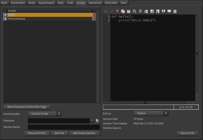

Here's what I'm trying to do:
I embedded a custom script in my HDA.
Is there a neat way to somehow execute/interact with logic from scripts adjacent to PythonModule? For example, I'd like to define a class in a separate script and then use it in PythonModule.

yeah, certainly can be done.
assuming a have another script called "Editor_PythonModule"
import toolutils
# load in the other python modules in the OTL
editor = toolutils.createModuleFromSection(
    "editor", kwargs["type"], "Editor_PythonModule"
editor.blah()
can't remember where i found out how to do this.
cheers,
chrisg

@chris_g I would have never discovered that on my own. Thank you very much, Chris! It works as expected.
