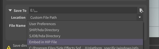

The functionality looks great. Dont understand how you embedded HDA into the HIP file, but i will figure that out.

In the asset creation dialog, drop down "location" menu, there is an option "ebede in hip file".
