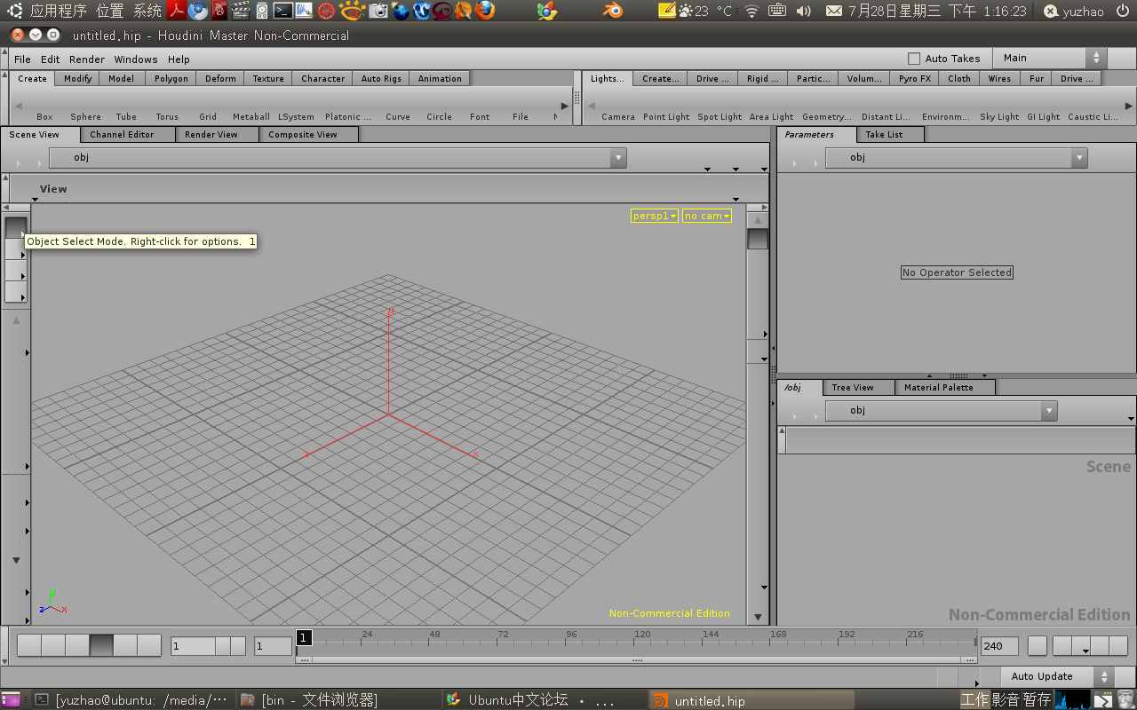

i install houdini 11 for ubuntu10.04,but there are no button icons too.just like:

it sloved. i gived the permissions on H11 preferences folder in my home folder.
cd houdini11.0
chmod 777 * -R
