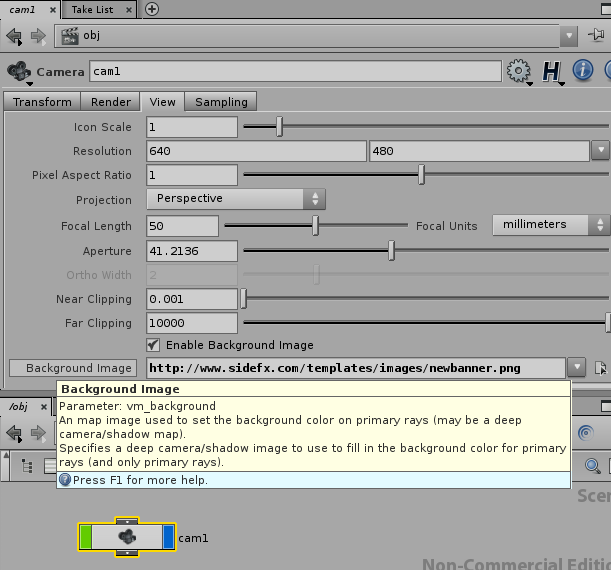

I want to set up this ‘sky’ background on my scene
and I was wondering if there's something like.. ‘image plane’ which is under Camera menu on Maya, on Houdini

In the Display Options (hotkey ‘d’ in the viewport) there is a Background tab where you can enter a background image for the viewport. Is that what you're looking for?
330 posts
Joined: July 2007
have you tried this ?
