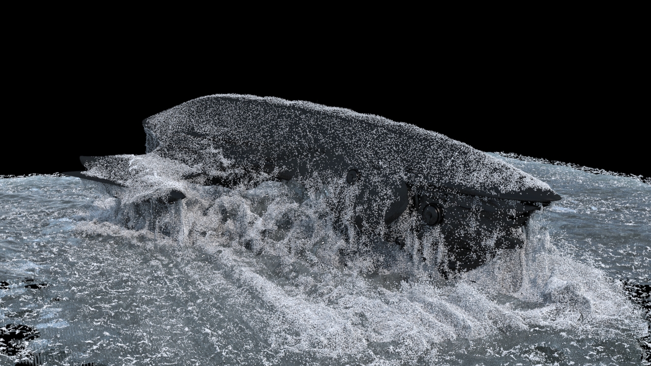

Thanks for answers Everything is ok now but i have one more question if I will render all my layers like foam,spray,ship in one time for EXR format I will get channels for post production for all layers forum Houdini or I should render separately foam, separately spray… Below test render )

No ,You can setup Channels for only one Mantra node , Then Houdini will render them one time in one exr file.(Actually this is multiple time in one exr !)
you should go to your mantra node and add Extra Image Plannes in the Properties->Output
You can simply add different passes for lighting (Indirect + Direct) , Z depth , Position , Normals , Reflection , Refractions and etc.
But if you wanna render foam , spray , ocean and etc in the separate pass ,You should do some changes on your project to export these data from Geometries and Material to the Mantra node , then call these data for rendering in the Extra Image Planes.
for example suppose you wanna have different passes for ObjectIDs .
So you can add a custom attribute with same name (e.g JKID) and different value for each object (Foam , Spray , Ocean) , Then export this attribute in the shader (Add a Parameter VOP node and set name to JKID and set Export parameter to Always).
Then add new Extra Image Planes and Set VEX Variable to JKID .
Finally the Mantra take JKID value for each object with it's material and it's Point/Primitive attribute and render this value in the Image !
