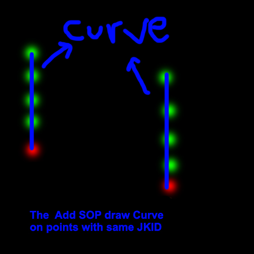

Source particles has an ID attribute that is unique between each particles , I made a simple attribute for saving these ID numbers , I call'd it JKID.
Now in the next particle network that useful for generating trail particles , each trail particle that generate from source particles has exactly same JKID attribute with it's own emitter (emitter for them is source particles).
Check Image 1;
and Finally the Add SOP draw a curve on each trail particle that have exactly same JKID number.
Check Image 2;
About Exporting these curves to Maya , you can use Alembic format , it can export curve to the Maya perfectly , Just if you use Arnold for rendering , Arnold in currently version has some problems with rendering Motion Blur for alembic files.
