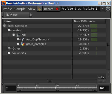

The interesting thing, is that when setting the value to 0 (first GPU) all is fine, when setting it to 1, then I get this error:
Open CL exceptiom clCreateKernelsInProgram
I am not sure what GPU is 0 and what is 1 in this case.
So I have to use 0 then.
The time saved using OCL in a sand simulation of 100 frames is in my case about 20 seconds, which means an improvement of approx 30%.
