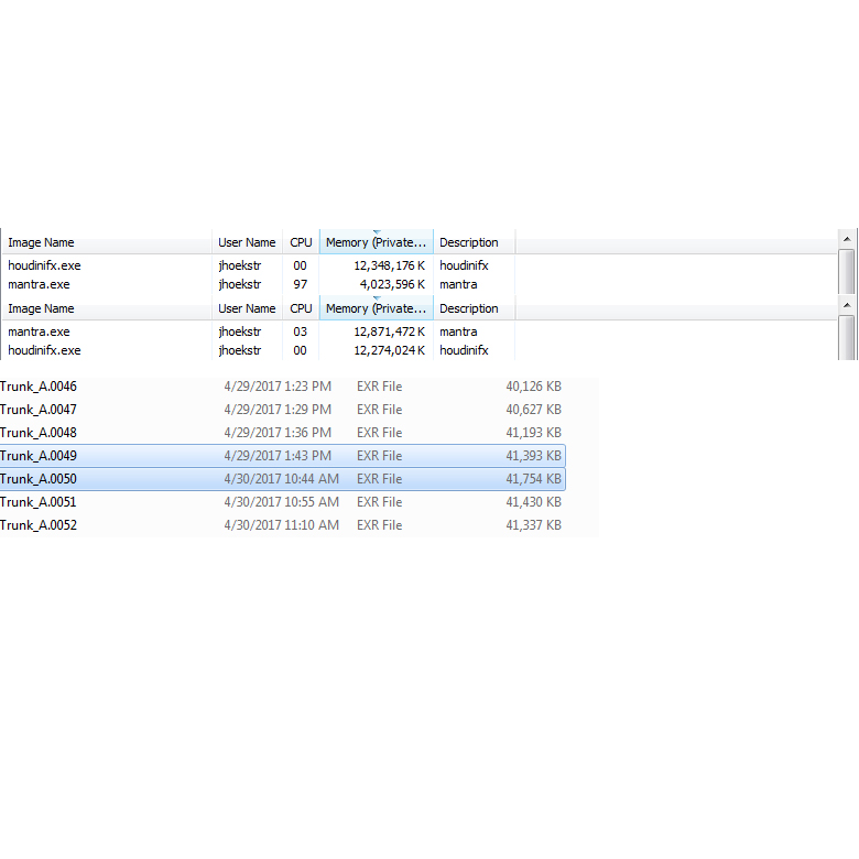

How much memory are they using? Can you post an example that demonstrates the issue?

It seems that the memory peaks at about 15 gb. I changed the cache memory ratio to 0.5 trying to fix the issue, didn't work tough.
In addition, today I work on the computer and After Effects takes sometimes upto 40 gb of Ram and the Render seems fine, only slows down a little bit.
I have 64 GB of RAM forgot to mention.

UPDATE: Seems the problem is fixed, I changed the material on the packed primitives. I'm not sure what's wrong with the previous material but I remember I had the same problem with packed primitives in a previous scene when they took a long time to render. Going 45 frames now with a average of 4 minutes, no spikes.
