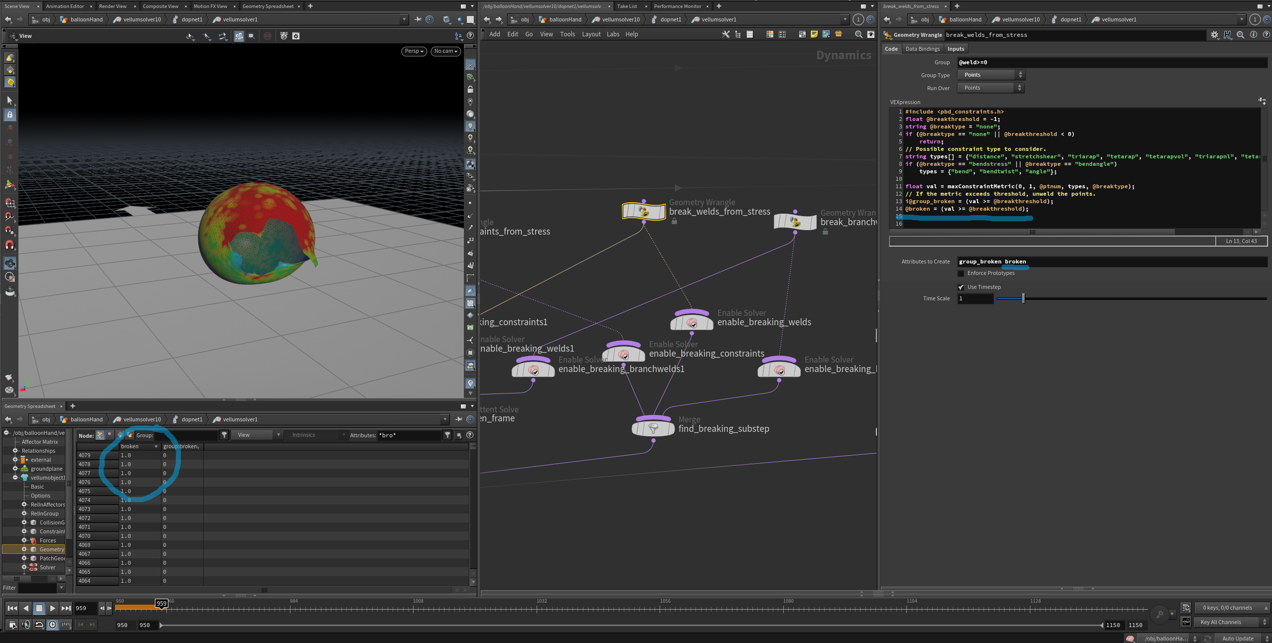

A bit yearish late on this one
But I've been in the same case those days, and i think i found some info to get that broken data out
So i have the test case of an inflating sphere with weld constraints that get broken through pressure.
Checking the group_broken on the points, it seems to stay empty even if there are some broken points.
I did unlock the vellumsolver and found where that group is set on the points. From there if I set an attribute @broken, which is not a group, and add it to the attributes to create channel, i can get that correct value broken with 1.0values in it
So from there to detect the frame of the break, it becomes easy i think, with a sopsolver, a blast keeping only points @broken=1, and an npoints() function checking if the blast gives 0 points or not would be a way of doing that probably !
